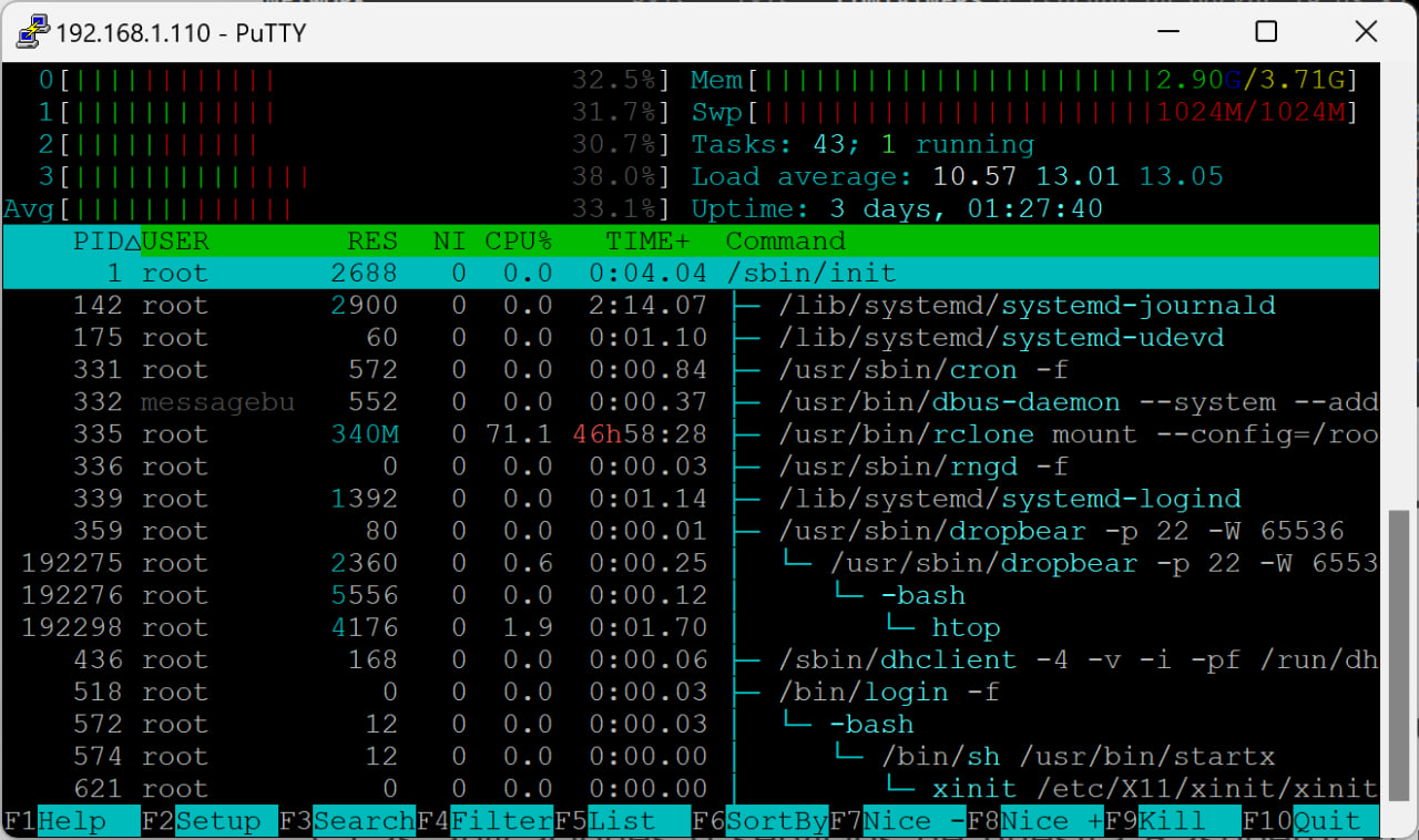

I have a Raspberry pi 4GB and I have halfway in htop and it tells me that it is using 1024 of 1024, should I increase it? I don’t understand much about the subject. I use it for qBittorrent, a bot that notifies me of stock of Amazon products and a Steam trading card collector, nothing more…

The next point would be to find out where the memory is used. On the small picture I see rclone. To get a better overview you can sort the column RES (mouse click).
