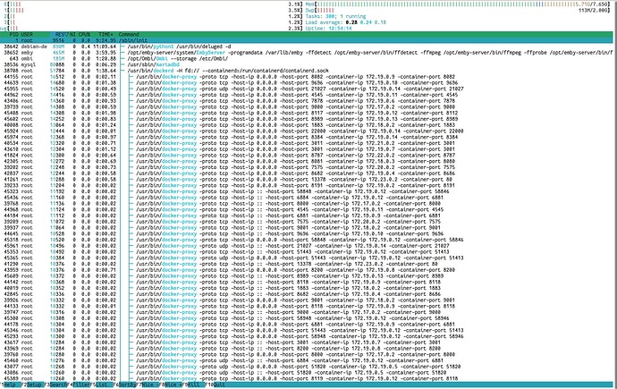

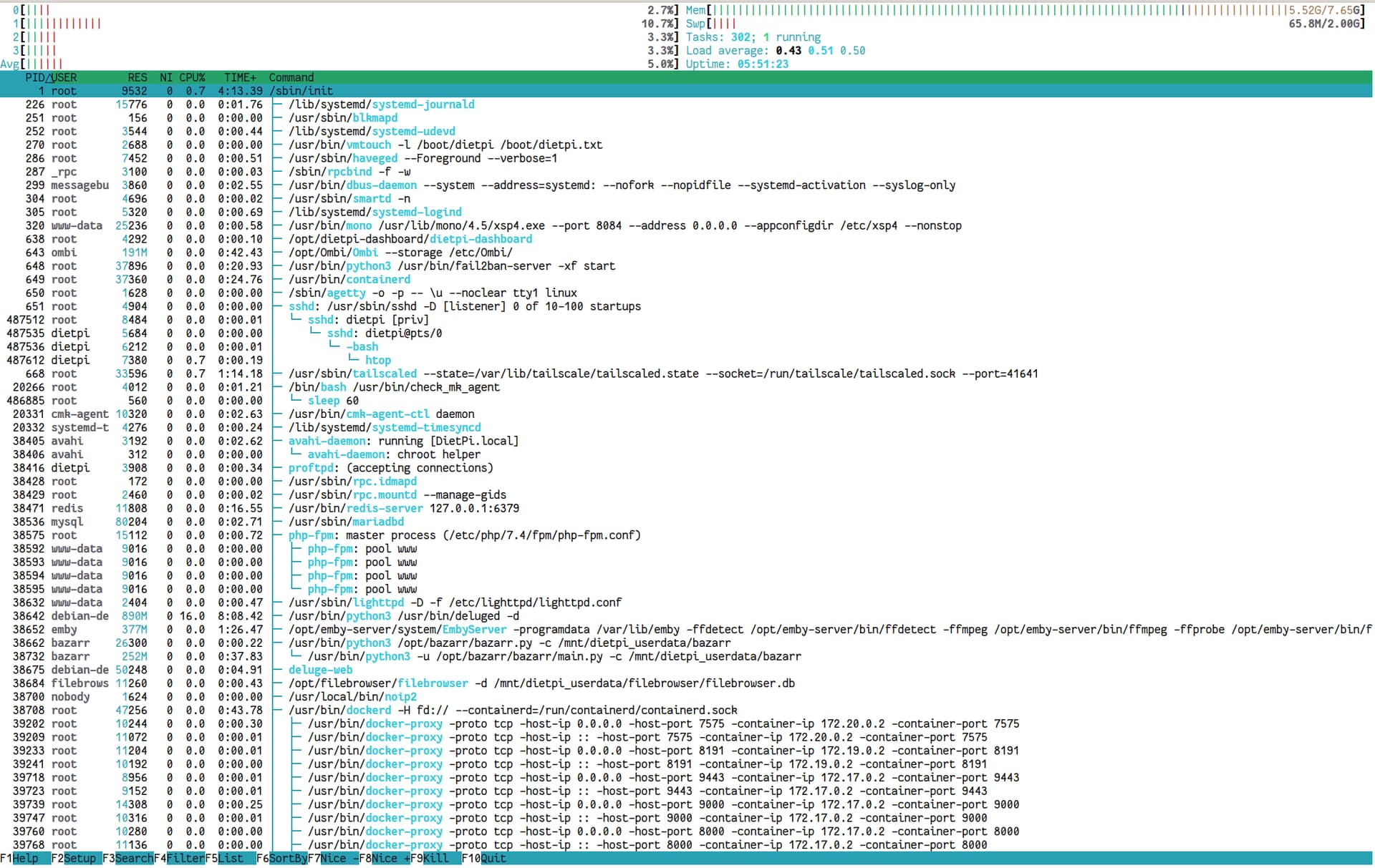

Can you check with htop which process causes this?

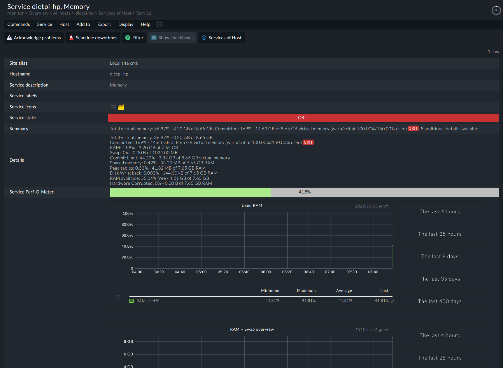

The warning you have is not a system warning. Looks like something from your monitoring tool. It’s a warning about virtual memory usage.
The virtual memory is his actual memory + his swap.

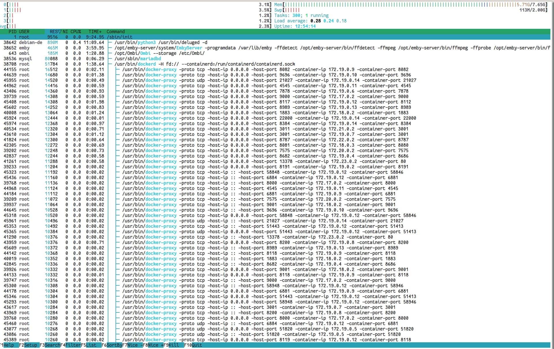

@przemko Can you sort the htop output by memory consumption please. (press F6 and chose M_RESIDENT)
Hm not sure, it’s possible ttat they use same memory, partially.
Can you collapse the process tree by pressing t please ![]()
It could be also a false reported error of the system monitor you are using. What monitor software is that?
Sorry for late response:
I used checkmk but now I uninstall it.
