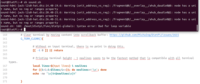

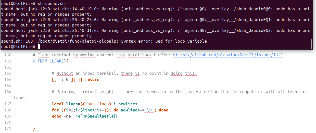

Hi again
I try with this two line at the top of the script or the end
#!/bin/bash
. /boot/dietpi/func/dietpi-globals
But i have an error at the line 168 of the dietpi-globals file
in this capture , the terminal and a view of the line 168
I search why ?? :blush: :blush:

Should be at the beginning of your script
I have the error with the two line at the top of the script :roll_eyes:
Something @MichaIng would need to have a look into
It is a bash script, so you need to execute it with bash. sh is bourne shell, dash practically on Debian.
Or you just add a shebang #!/bin/bash as first line, make it executable, and execute it directly.
Btw, at which point is this script needed? /boot/dietpiEnv.txt should always exist :thinking:.
