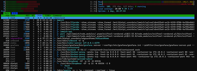

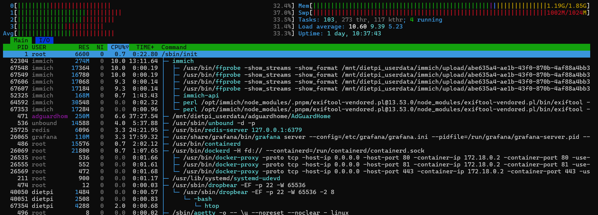

Ok. I was able to upgrade and install immich, now comes the dilemma. Check hows my system with it installed and do you recommend me to keep it and see how it goes or uninstall it. Look hows my memory and swap. Im starting to backup the photos/videos i guess thats the main reason for so memory consumption.
Unfortunately, this is normal behaviour when loading images into Immich. The time it takes depends on the number of images and videos. Once the images have loaded, the memory usage will drop again. You just have to sit through this initial phase; otherwise, the images simply won’t load. In the settings, you can see how much is left to process.
It’s best to just give it a go once everything has been uploaded.
Personally, I’ve installed Immich on a NanoPi M6. I’ve imported around 259 GiB of data into Immich via an external media library. Currently, that amounts to 71,323 photos and 5,243 videos. The total DietPi system memory requirement, including Immich Core + ML, is now 1.9GB of RAM.
Yes, Immich can certainly work on your system. However, you will always use SWAP to some extent. Sometimes more, sometimes less.

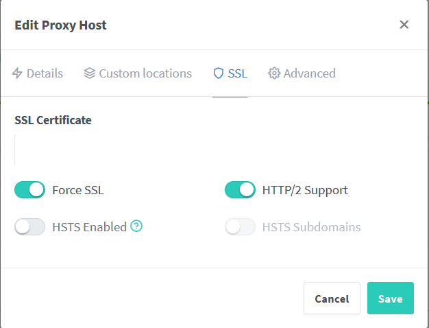

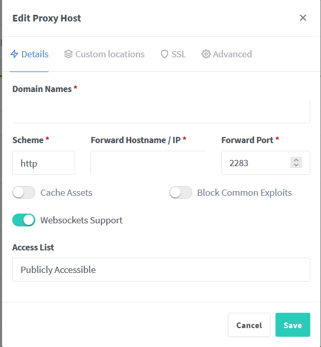

I have a problem with videos that are larger than 500mb. they get to 97% or something like that and they fail… this are the only settings that works on nginx others that i have tried put the website offline so i had to remove some options and leave only the ones that works with try/error approach:
#allow large file uploads
client_max_body_size 50000M;
#increase body buffer to avoid limiting upload speed
client_body_buffer_size 1024k;
#set timeout
proxy_read_timeout 600s;
proxy_send_timeout 600s;
send_timeout 600s;
proxy has nothing to do with Immich directly. Try without proxy to exclude this level
it worked directly putting my local-ip. So the problem is in the proxy. theres probably a custom settings that i need.
Yeah those were the settings i had set before but it was rejecting the two big files, these are the ones i was talking about:
send_timeout 600s;
With those 3 it should have been working. but its not
maybe something you would need to ask on NPM GitHub on how to deal with large file uploads.
