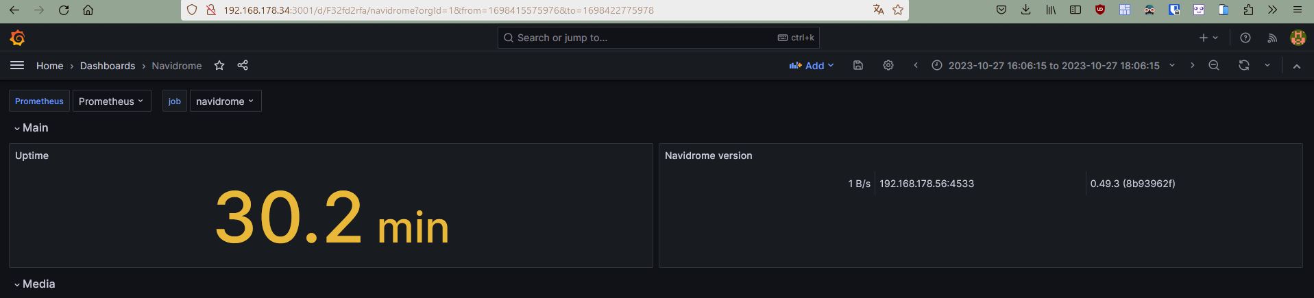

  • I should be able to see navidrome metric in Grafana dashboard
  • Unable to view navidrome data on Grafana dashboard

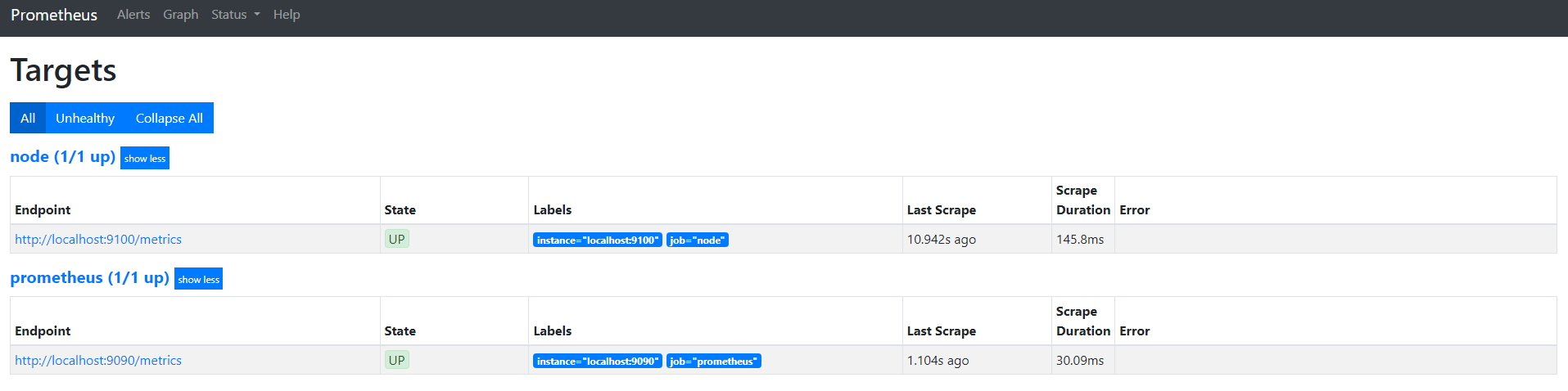

Promethus.yml file
Navidrome.toml
Promethus server status
Node exporter status
Grafana server status
Probably you need to change the lines /metrics_SOME_SECRET_KEY to something meaningful.
Is prometheus complaining about this path?
journalctl -u prometheus
I tried using /metrics , and the same thing happen cant see any information in the dashboard

I got some more info from Discord:
the secret is key is something you would generate as you are exposing server metrics which you would want to keep private.
and it should be Prometheus.Enabled = true in toml file, to enable it.
its just a url path where the data is being sent
you should have some random string like metrics_sjhdf8h8923LF898 as your path to keep it secure, but leaving it as metrics_some_secret_key also works , just make sure you update it in both places
(see also https://www.navidrome.org/docs/usage/configuration-options/#available-options)

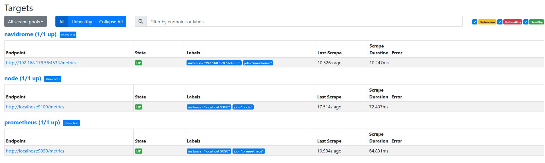

So this is what you already did. The only difference I can see now is the line Prometheus.Enabled = true without the ' ', which makes sense since it’s a boolean and not a string. You can also see in the link above which values are strings and which not. so probably a modification to Prometheus.Enabled = true will do the trick now and enable the metrics feature.
Probably this misconfig will also show up in the logs, which we could’ve checked in the first place :sweat_smile:
`journalctl -u navidrome.service’
btw you have set another 'true' in your config for EnableLogRedacting

I have edited the config in both promethus and navidrome and still not show any mertics in grafana dashbaord

I have no other idea then. Did you restart navidrome after the changes?
edit: I will test this for myself this afternoon.
This seems to be important.
But there is no login, you could use a “secret” metrics path to make it more secure. :thinking:
edit:
Now I see what is wrong, in your prometheus config you have two times scrape_configs. I assume it can only be one block. My conf looks like this:

I got it working on my system now
Here is what I did:
  1. In navidrome config /mnt/dietpi_userdata/navidrome/navidrome.toml I added
and restarted navidrome systemctl restart navidrome.service
  1. In prometheus config prometheus.yml I added:
 - job_name: navidrome
    scheme: http
    static_configs:
      - targets: ["192.168.178.56:4533"]
Then I just started prometheus (I used precompiled binary).
I did not set a metrics path at all, since my navidrome instance is not public.
I can also see values at http://192.168.178.56:4533/metrics
Maybe you can check if this is also the case for your navidrome instance, to make sure the endpoint is enabled.

it does show metrics now in the dashboard , thank you so much sir you are the boss , my next one will be monitoring pihole , I might need your help if i ran into issues lol .
