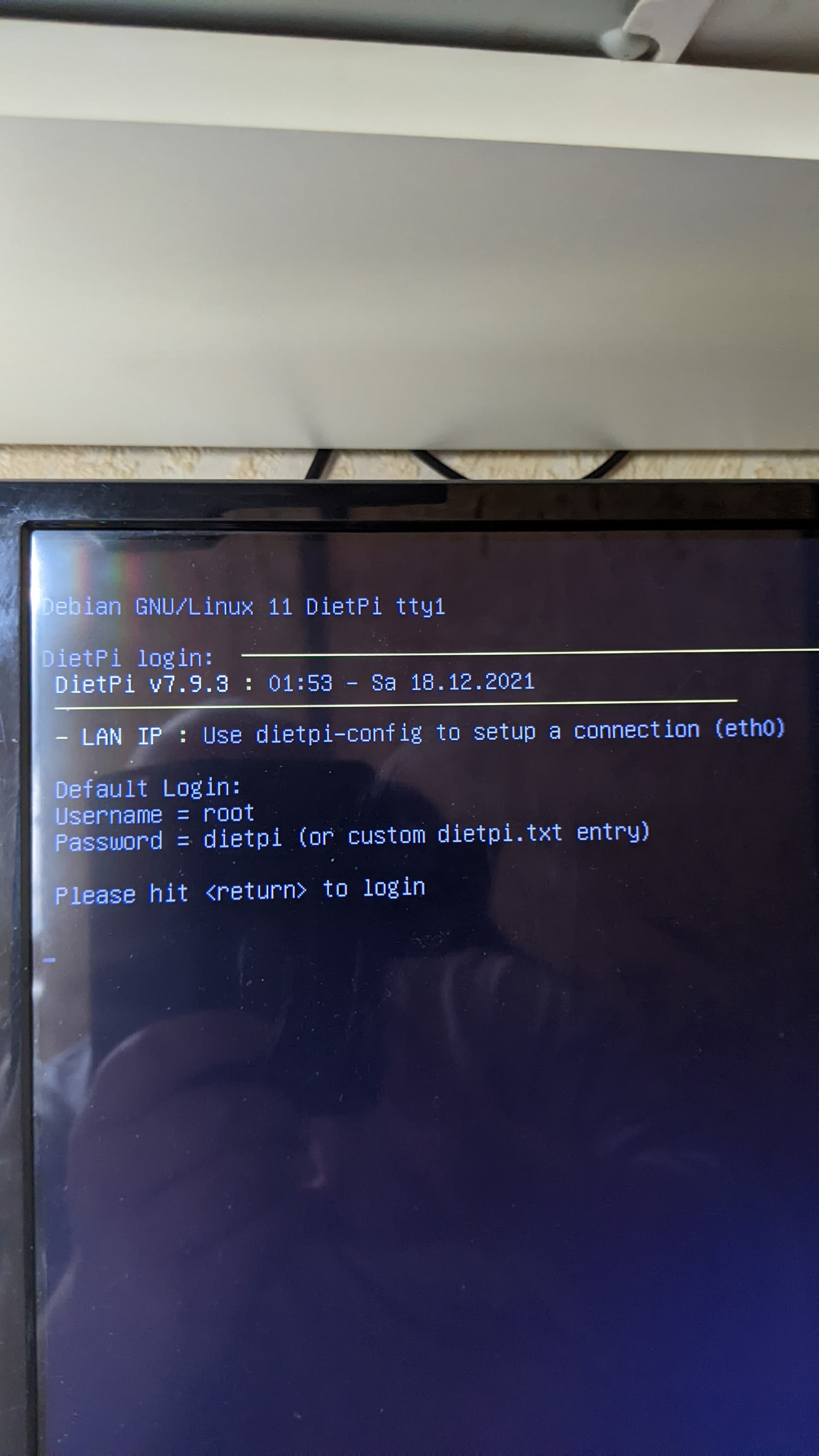

I can’t get Dietpi to run on a Rock pi 4C_plus. I get to for the login after the installation and that’s it. The RockPI is frozen.
I’ve already tried a few things. Image written directly to emmc and worked without emmc. The result is always the same. Is the problem known or am I just too stupid? :slight_smile:

Can you share some more information. Are you going to login via SSH or some local console? Can you share a picture of what you are seeing on screen? Once the system is frozen, are you able to login via another SSH session?

Dietpi-os boots with LAN error (totally ok) and then hangs at login. No keyboard is accepted, I cannot press RETURN as requested to go to login.
