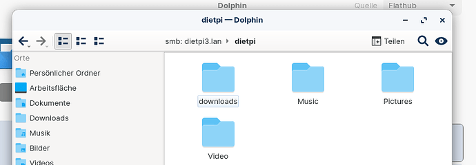

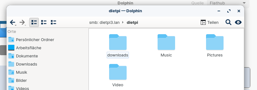

Well :smiley: I’m able to see my DietPi Samba share on Zorin

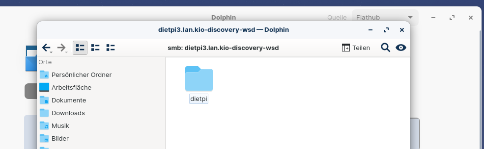

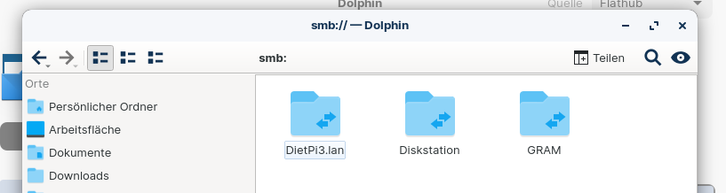

Secret is to use Dolphin file manager instead of the regular on. It’s using wsd as well to discover samba share. Therefore, you need to install wsdd2 on your DietPi Samba server
OK I have to install Samba server… only the server right ?
Because I’ve also seen a cliet or something like that.
Then I will install wsdd2.
Furthermore I will install Dolphin file manager.
Am I correct ?
On the client side you just need samba-client and packages to get your file browser working with smb shares.
Samba server + WSDD2 to be installed on DietPi
Dolphin file manager can be used in Ubuntu to get the possibility to search smb shares within the network. It’s optional and not mandatory.

PS: DietPI is working fine now with Windows 10 and Ubuntu. Finally !!!
There is also something in our doc about it: File Servers Options - DietPi.com Docs, see tab " Use wsdd to view shares"
