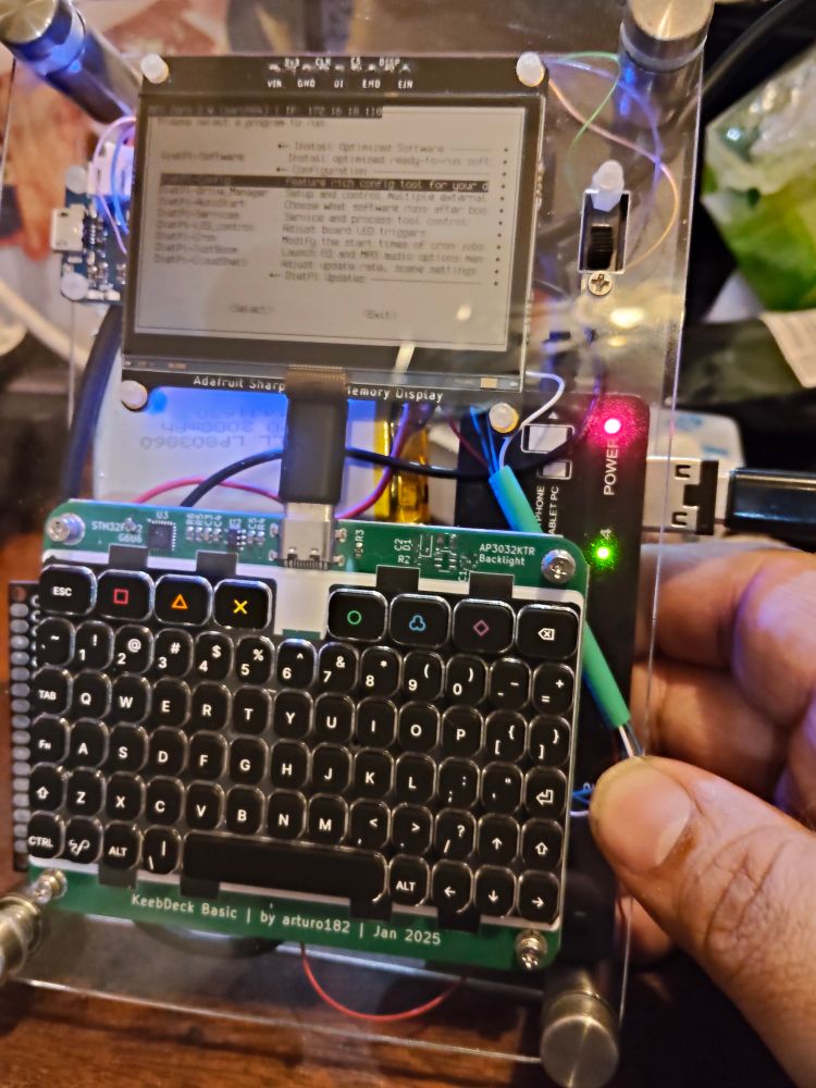

I admittedly have a rather unorthodox setup to say the least. It’s basically a handheld cyberdeck that’s sort of like a SQFMI Beepy.
  • Software title | I²C stack
  • Was the software title installed freshly or updated/migrated? Not sure, perhaps there have been kernel upgrades going to 9.20.1 that might have done strange things to I²C
  • Can this issue be replicated on a fresh installation of DietPi? I have tried a fresh image of DietPi 9.20 Trixie but I²C still does not work. An i2cdetect -y 1 just shows all I²C addresses as empty. Same with Bookworm.
I’m pretty sure that I soldered the I²C pins properly on pins 2 and 4 (GPIO2 and GPIO3), and even tried plugging them in directly with DuPont wire with no luck. I have been testing a DS3231 ZS-042 RTC board and a SSD1306 OLED module. I’m pretty sure that they work, because I plugged them into a Bus Pirate and it has no trouble detecting and sending them commands. The ZS-042 board has a power indicator LED and it burns bright when it’s plugged in. Alternatively my RPi Zero’s I²C could be broken, but I tried grounding the SDA pin and i2cdetect -y 1 detects devices on every address as expected. Not sure what else I can do to diagnose this issue.
