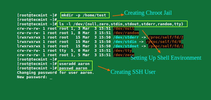

I have built and installed omxiv, and installed omxplayer as root. It works fine. Now I will create a new user - and what do I need to do? Build&install omxiv, install omxplayer as that user, then apply restrictions to that new user with chroot instruction from the first link?

The guide in the first link is the effective way to completely jail the user. But as you can see, this requires to copy all required binaries and libraries into the chroot environment. So you need to identify everything that is required for omxiv and make it available within the chroot environment. Some /dev /sys /proc files might be required as well.
At least I would not create copies, but hardlinks via cp -l -v source dest, so no doubled disk space is used and APT updates are applied to the chroot environment as well.
I am trying to implement chroot according to Tecmint guide… how do I determine what do I need for omxplayer to work, apart from its shared libraries?
Not sure, it needs ALSA and dbus access, besides the above mentioned, /run ist most likely required to allow access to the dbus socket. Not sure how ALSA access technically works. Why not simply try and error? Nothing to loose and I guess starting omxplayer from inside the chroot then should give some error message from where additional needs can be hopefully derived.

Omxplayer has a very bloody long dependencies list, it gets me depressed just looking at it. Frankly even following the guide to enable shell was a chore because libs are stored in different folders. Can I do something to restrict regular user from accessing stuff with creating a chroot jail, e.g. with user permissions like on Windows - or will it be insecure?

Of course you can solve it via user permissions as well, but the basic issues stays the same that you need to know which files/dirs access is required to and which not. So actually the chroot is easier then since the other way round you would need to adjust permissions for every single file that you want to block access for the user. And this can even break other stuff and new files/dirs are by default world-readable.
Another idea is to only allow the user to run a single command (omxplayer) + perhaps logout/exit: https://stackoverflow.com/a/21649384
IMP easier than setting an empty string alias for every single existing command would be to override the PATH variable for this user to e.g. /home//bin and symlink the commands there that you want it to be able to call. By this at least practically changing dir, reading files etc. is not possible without the need for chroot. But I guess rbash is saver to block this on a lower level.
