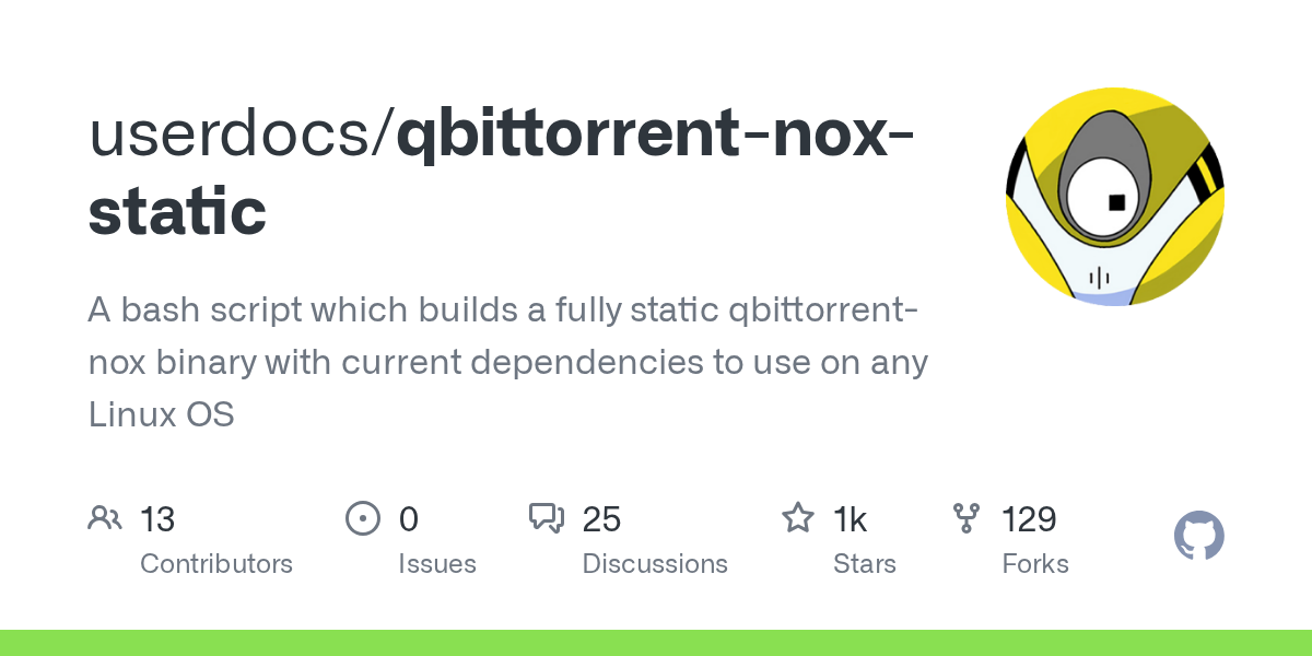

Some googling and i found this.
Could somebody check my tutorial.

go to
copied commands from
mkdir -p ~/bin && source ~/.profile
wget -qO ~/bin/qbittorrent-nox https://github.com/userdocs/qbittorrent-nox-static/releases/latest/download/armv7-qbittorrent-nox
chmod 700 ~/bin/qbittorrent-nox

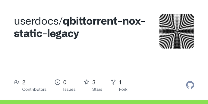

@KamikazeePL if you want updated v4.3.9 you want this build
