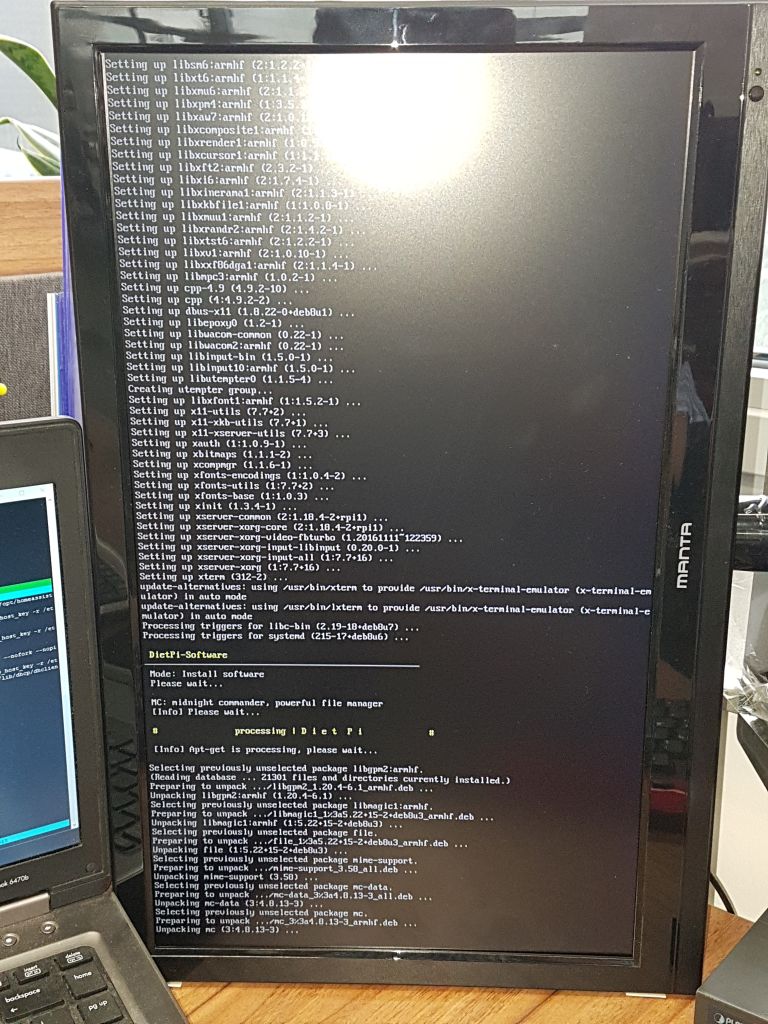

But my DVI-connected display (through HDMI-DVI adapter) is SXGA (1280x1024, 5:4) size and I have rotated it 270 degrees. System does not adjusted automatically. So texts on CLI and graphics on GUI are displayed incorrect ratio, and rotated.
I can rotate a screen only in GUI in this way…
Add line Option "Rotate" "CCW" to Section "Device" of /etc/X11/xorg.conf
but this is not enough to solve the problem because graphics are still displayed incorrect ratio.
Anyone know how to change display resolution and rotate settings fundamentally?
