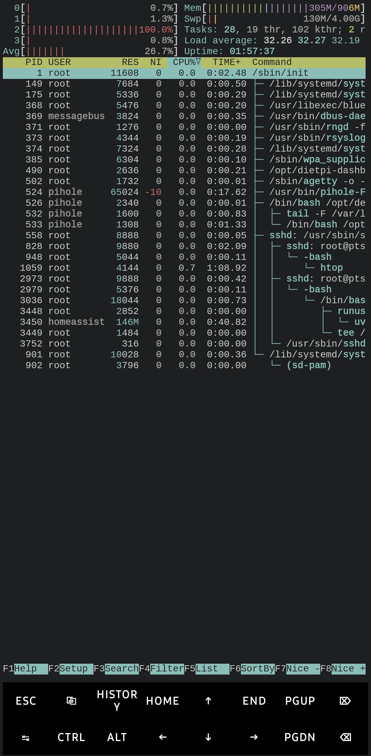

I can not open another ssh at this point but I have another ssh opened with htop running and that seems to be showing as active. The uptime timer is counting up like normal. (Picture attached).
root@DoBox:\~# dietpi-software reinstall 157

Some time later and I still can not open a new SSH and the htop from before seems to still be running.
I exited the htop and it froze when it went back to the terminal.

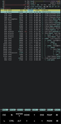

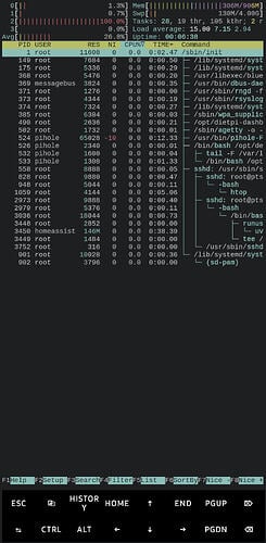

I did wait about 2 hours. I have 2 images in a post above showing the uptime with no activity from the updater script. I could have waited longer but that pi is also the DHCP server/ad blocker and the rest of the household was looking at me.

Looking at the kernel log, it appears as though all read and write operations are stalling on the SSD. This can happen due to power supply issues or a very high I/O load when swap is in use. This is probably the case here. During compilation, the RAM runs out and the system starts swapping. With a high SWAP load, this can almost bring the system to a standstill.
How is the SSD powered? Just by the USB port or has it an own PSU? And what exactly you store on the SSD? The entire user data directory? Where is the SWAP file located?
So I assume rootfs, userdata and swapfile are all on the same SSD, also since it is partition 2.
Even if at its limits, of course it should not crash the system. But to run stable, indeed a dedicated PSU is surely needed.
Other than that, some tweaks might enhance its performance. E.g. if its I/O scheduler is bfq by default, mq-deadline might work better on SSDs, as it is simpler, theoretically better suited for fast drives with low latency, like SSDs.
And does it support APM?
hdparm -B /dev/sda
Last but not least, UAS (USB Attached SCSI), has shown to cause some problems with specific drives, e.g. due to outdated firmware. But that usually shows up immediately, preventing booting from the drive. Very unlikely to be the culprit in your case, since it obviously worked well before.
Yeah the SSD is powered from the USB port and the pi is powered via poe.
https://a.co/d/0dGm9NZz
Everything is on the SSD and I have the swap at 4gb.
The usb adapter and SSD are these
https://a.co/d/05K0t4pC
https://a.co/d/094szGPM
“Yeah the SSD is powered from the USB port“
This is the problem then! Likely
