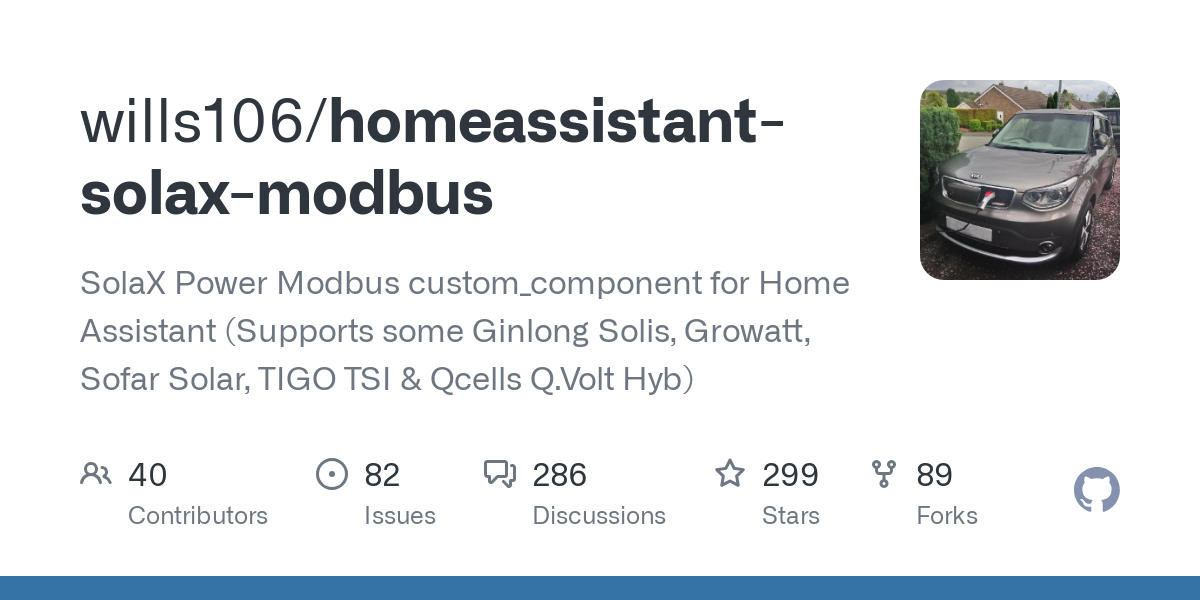

Then there is a fresh issue about the SolaX error in github:
https://github.com/wills106/homeassistant-solax-modbus/issues/1008

It was a bug in the Modbus plugin itself. This has been fixed with the new version 2024.08.12.
Now everything works
