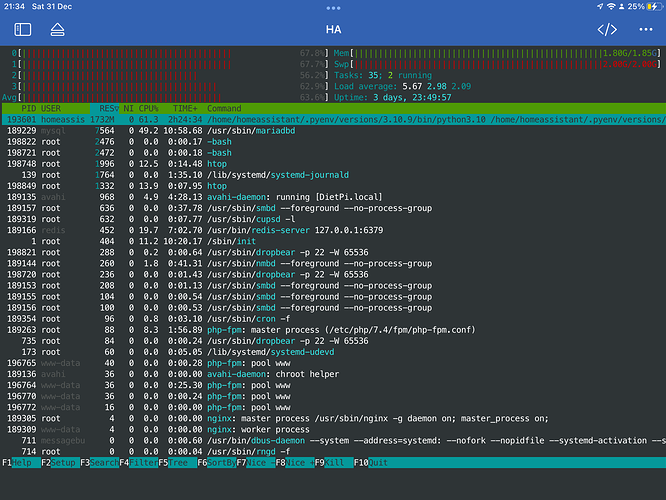

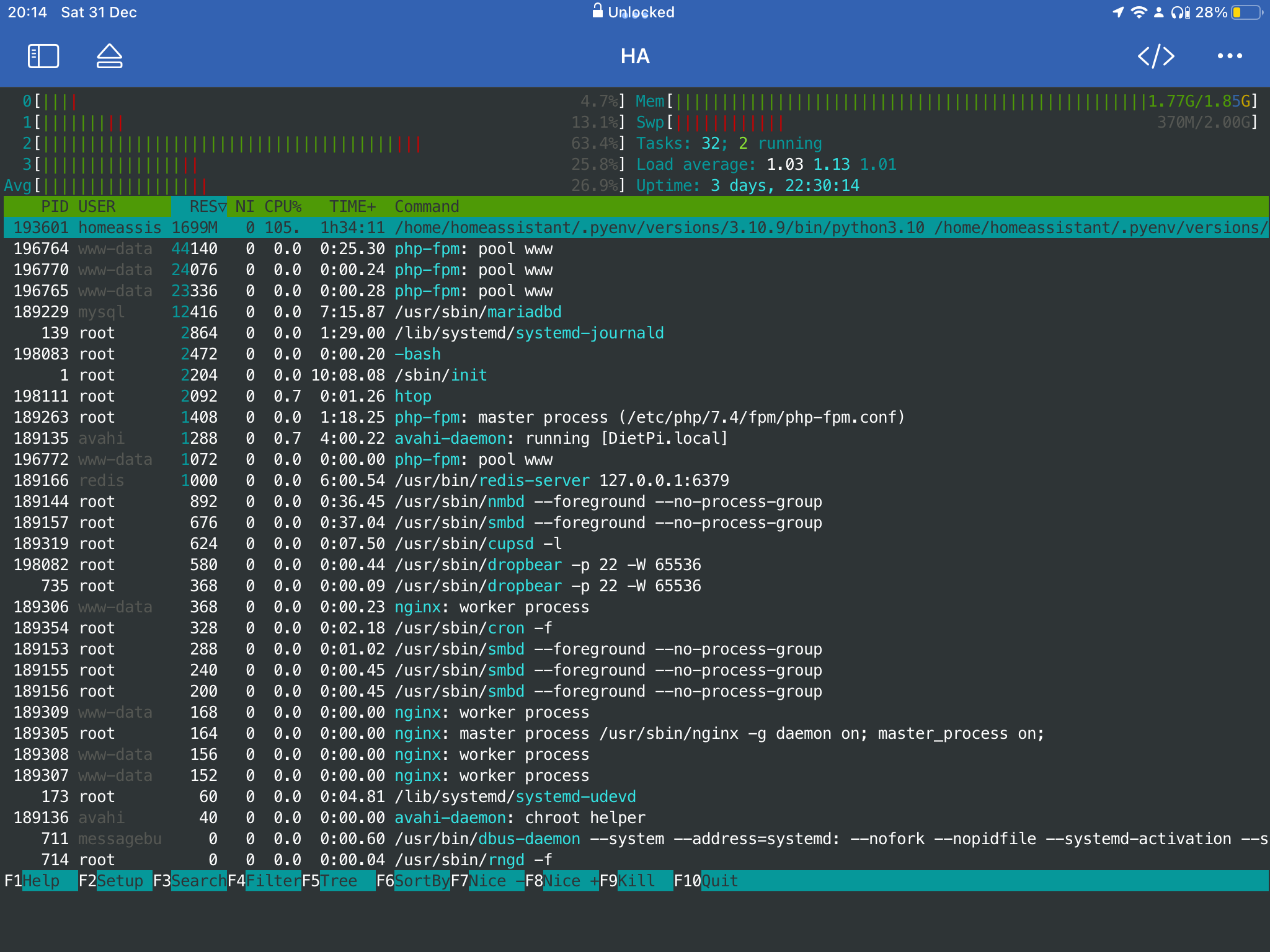

Home Assistant crashing since upgrading to DietPi v8.12.1 and HA 2022.12.8
G_DIETPI_VERSION_CORE=8
G_DIETPI_VERSION_SUB=12
G_DIETPI_VERSION_RC=1
G_LIVE_PATCH_STATUS[0]=‘not applied’
bullseye 0
  • Kernel version | uname -a
Linux DietPi 5.15.76-v8+ #1597 SMP PREEMPT Fri Nov 4 12:16:41 GMT 2022 aarch64 GNU/Linux
RPi 4 Model B (aarch64)
5v 3A Official Raspberry Pi Power supply
None, booting direct from USB SSD
Home Assistant
Old install, DietPi was updated using dietpi-update
Home Assistant was from 2022.11.X to 2022.12.8 with the upgrade script provided by DietPi. Home Assistant started crashing after about 8 hours of running, so I reinstalled Home Assistant using dietpi-software reinstall 157
Home Assistant is still crashing after 8 hours or so.
I have noticed the Apple TV integration is not working and I am getting alot of errors in the logs. I do not know if this is causing the crash. I don’t use the Apple TV integration but I am unable to remove it.
I don’t know, I do not have the hardware to test this.
Extract from journalctl -u home-assistant

ok, increased the swap file as above. This has helped me witness the problem, since it now takes longer to crash. But it seems HA eating all the RAM. Between 20:14 and 21:34 this evening HA went from using 1699M RAM and swap file at 370M to 1732M RAM and swap file to 2GB.
I’ve disabled all custom integrations and disabled all non critical integrations is HA. Any idea how I can debug further?
I managed to get this out of dmesg whilst it was out of RAM.
Any idea what SYN Flooding is?

[288639.160669] [ 189354]     0 189354     1413       23    45056       41             0 cron
[288639.160688] [ 192969]     0 192969     2227       89    49152       27             0 cron
[288639.160705] [ 192970]    33 192970      516       17    36864        0             0 sh
[288639.161320] [ 192971]    33 192971    32740     3810   180224        3             0 php
[288639.161352] [ 192977]     0 192977     2139       73    49152       16             0 cron
[288639.161372] oom-kill:constraint=CONSTRAINT_NONE,nodemask=(null),cpuset=/,mems_allowed=0,global_oom,task_memcg=/,task=hass,pid=189334,uid=998
[288639.163020] Out of memory: Killed process 189334 (hass) total-vm:3702068kB, anon-rss:1811844kB, file-rss:0kB, shmem-rss:0kB, UID:998 pgtables:3880kB oom_score_adj:0
[295766.822111] TCP: request_sock_TCP: Possible SYN flooding on port 8123. Sending cookies.  Check SNMP counters.
[307322.886212] Adding 2097148k swap on /var/swap.  Priority:-2 extents:21 across:97779708k SSFS
Could be some kind of Denial-of-Service-(DDoS) or similar flooding the port 8123 (HA). Is your system reachable from internet directly? If yes, try to close the port.
