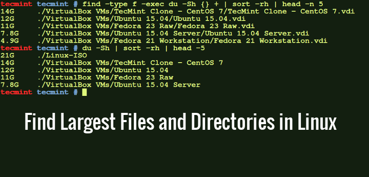

ncdu might help as well
once you find the offending disk usage…you can remove the files/directories
Your list from above shows something in the /mnt directory using 48GB of space…poke around in there

To get more details on where disk space is used
du -aBM / | sort -n -r | head -n 20
