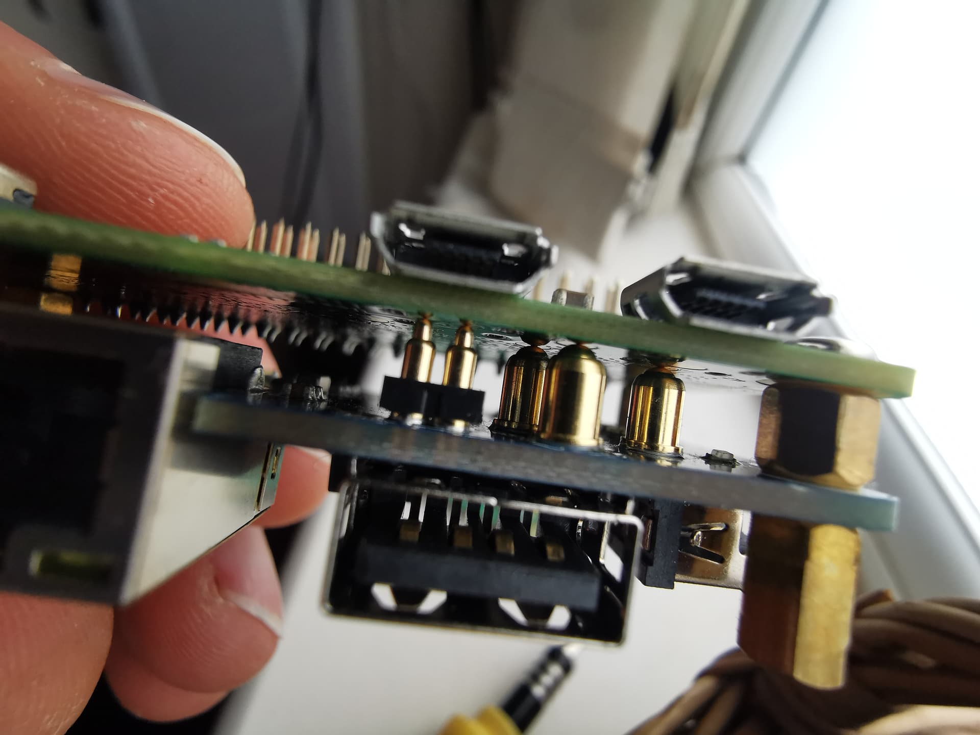

The thing is that the HAT, on its own, works as far as I can tell. When I plug it into my Laptop running Fedora, and I plug in a usb flash drive in it, it gets automatically mounted by the OS and I can browse the contents from it.
No, it does not show in lsub

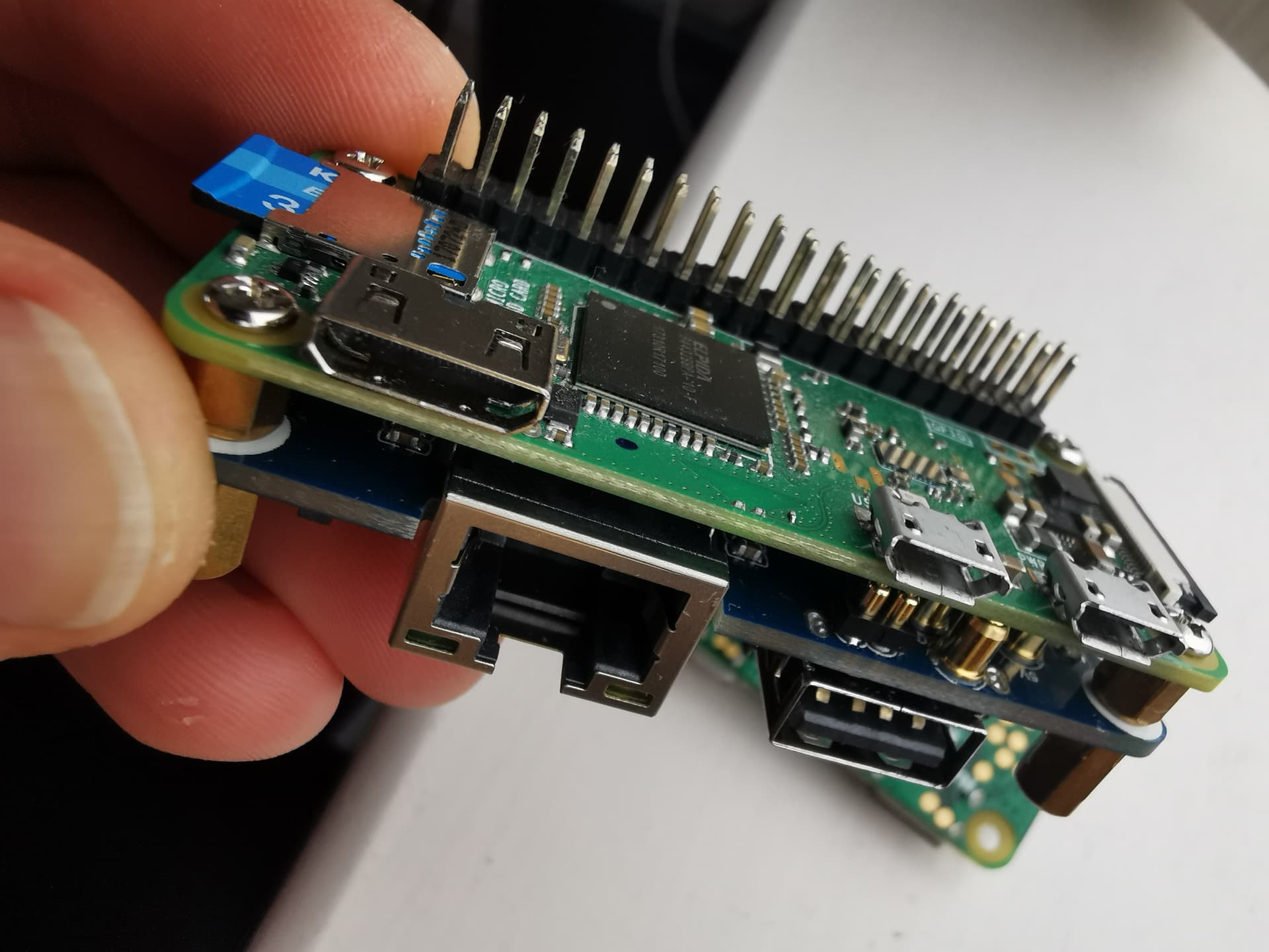

The pogo pins are making good contact (and with the right side of the Raspberry Pi Zero W :sweat_smile: ) , with the M2 screws tightly keeping the hat in place.

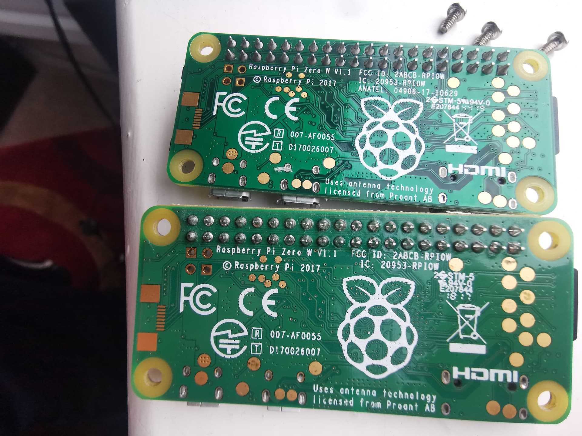

By the way, it is a v1.1 board (Actually I tested 2 Zeroes W that I have around, as depicted, with no difference) and -as far as I can see- have the relevant pads in the corrects locations for the pogo pins.

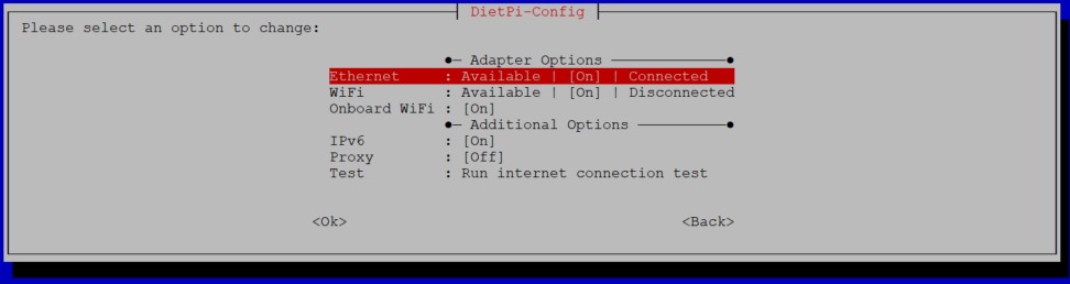

After changing these by the official PSU from a Raspberry Pi 2 I had around (5V 2.5A) the hat was identified by lusb and the Ethernet port also recognised by the DietPi-Config util.
