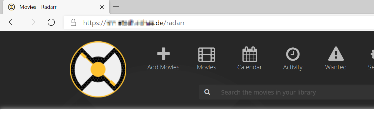

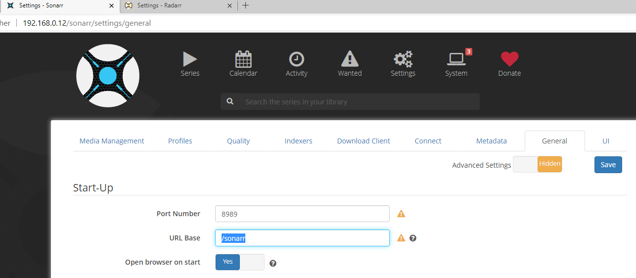

ok i did a test on my RPi3B+ with lighttpd, sonarr and radarr. Basically I used your configuration and it’s working fine
I did a fresh installation without any configuration changes.
- activated 10-proxy.conf
root@DietPi3:/etc/lighttpd/conf-enabled# ls -la
total 8
drwxr-xr-x 2 root root 4096 Nov 17 15:47 .
drwxr-xr-x 4 root root 4096 Nov 17 14:07 ..
lrwxrwxrwx 1 root root 33 Nov 17 14:07 10-fastcgi.conf -> ../conf-available/10-fastcgi.conf
lrwxrwxrwx 1 root root 31 Nov 17 15:47 10-proxy.conf -> ../conf-available/10-proxy.conf
lrwxrwxrwx 1 root root 37 Nov 17 14:07 15-fastcgi-php.conf -> ../conf-available/15-fastcgi-php.conf
lrwxrwxrwx 1 root root 38 Nov 17 14:03 99-unconfigured.conf -> ../conf-available/99-unconfigured.conf
- configured 10-proxy.conf

- changed base URL in radarr and sonarr
- restarted all services
Did you changed base URL on both application GUI’s??
Below some screenshots showing the URL without port and the changed URL Base
