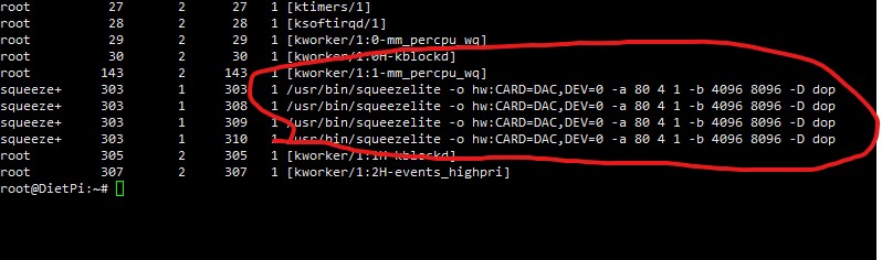

How does the GPIO interface of Raspberry Pi 4 output DSD source code? Can it only DOP? Is it the reason for the drive? The digital version of i2s I’m using now can only be DOP
Can only DOP through gpio to i2s digital version, is it a driver problem or does the Raspberry Pi itself not support Native source code output? I don’t understand Linux principles. USB is not native
