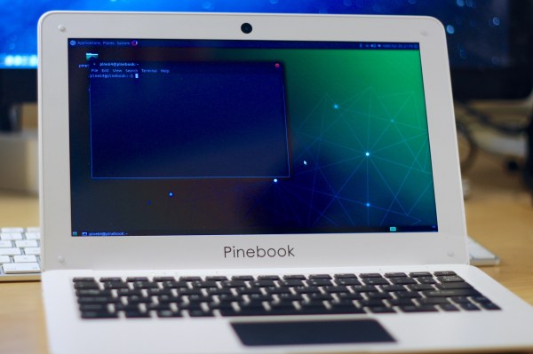

Owner of Pinebook 11" and I could not stand the sluggish KDE they installed so I eventually downloaded many distro they proposed on their wiki until yours showed up in the list and I remembered using it on a raspberry long ago.
It rocks on the pinebook! So, thanks to the whole team responsible for this release.
Hopefully I’ll understand how to install it on the embedded storage in place of the SD card one day.
