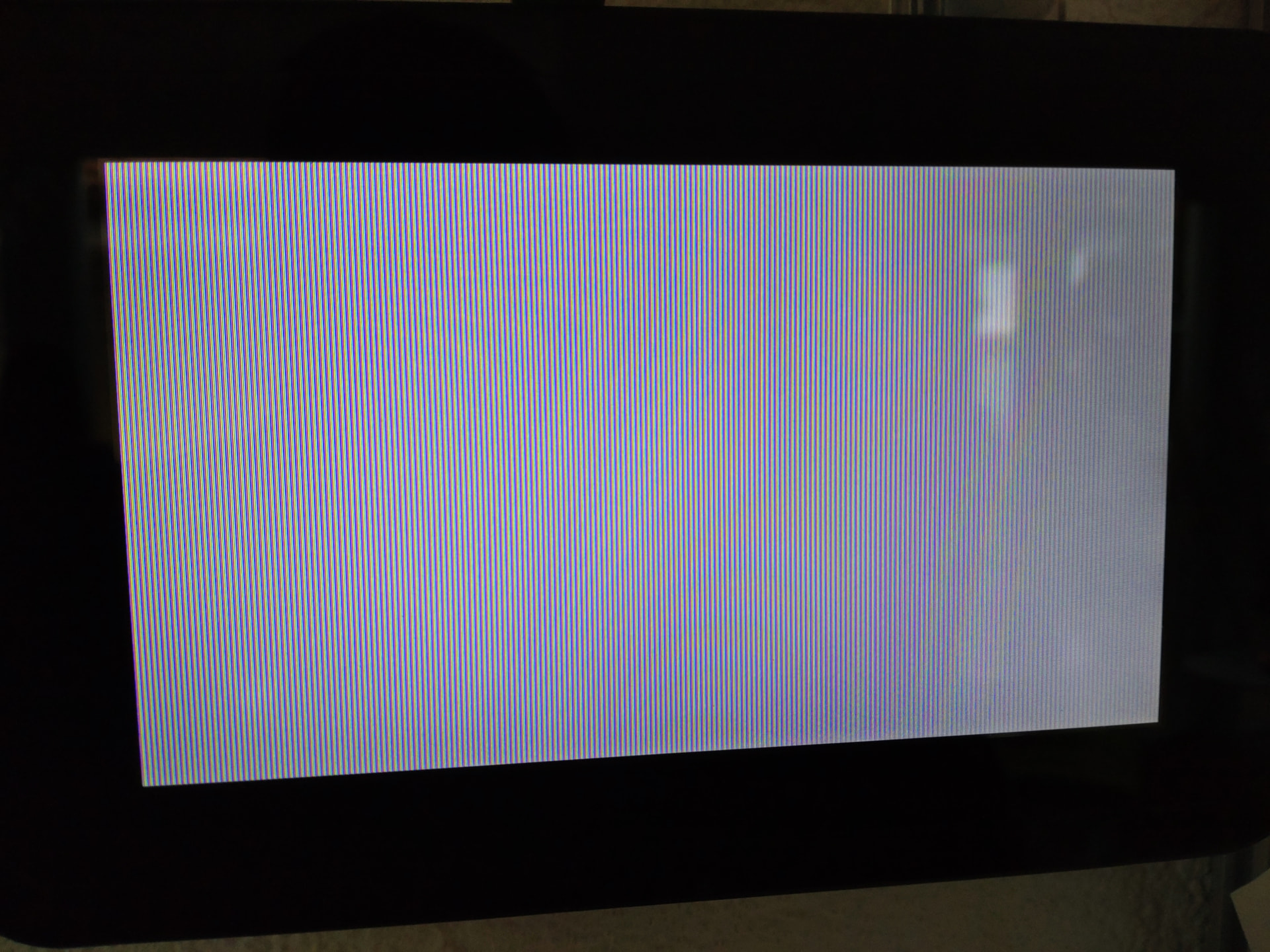

If i enable “dtoverlay=vc4-kms-v3d” in “/boot/firmware/config.txt” i always only see this screen on the 7” Original RPI-Display over DSI (It doesn’t matter whether I choose cli or x11 to start.):

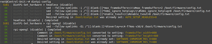

Yes, it is set to “RPi Touchscreen : 800x480” which should match i think.
It looks like it sets:
framebuffer_width=800
framebuffer_height=480
The first two are not a problem, but as soon as “dtoverlay=vc4-kms-v3d” is set the screen has only white stripes.

If “dtoverlay=vc4-kms-v3d” is missing then x11 does not start with user dietpi. And if it is there the 7” Display does only show white stripes. Only if both options are there all is good and working.

If you select “7” Touch Display” in dietpi-conf, it only sets “dtoverlay=vc4-kms-v3d” but it should also set “dtoverlay=vc4-kms-dsi-7inch”. Both entrys in config.txt are needed.
Basically dietpi-config requires a major rework to remove all legacy (non-DRM/KMS) graphics options, which means that almost all LCD options are removed as well. Instead, there is the generic display_auto_detect=1 to enable supported overlays automatically based on detected hardware. Does this work as well instead of vc4-kms-dsi-7inch? vc4-kms-v3d needs to remain, of course.
With which dietpi.txt setting or which dietpi-config option? A valid 7" DSI display option does not exist, and vc4-kms-v3d is only enabled when selecting the respective resolution entry (or when installing software which requires KMS/DRM).
It removesvc4-kms-v3d, as this way of setting the resolution only works with legacy graphics. Also, this menu is/was really only supposed to set the resolution, not to enable DSI display support. With legacy framebuffer driver, there were overlaps, but the DSI displays (compared to HDMI) usually require some additional changes done via device tree overlay, or scripts/services.
This all needs to be removed from dietpi-config, in favor our dietpi-display to set the resolution with KMS/DRM, and a generic LCD support toggle which sets display_auto_detect=1.
