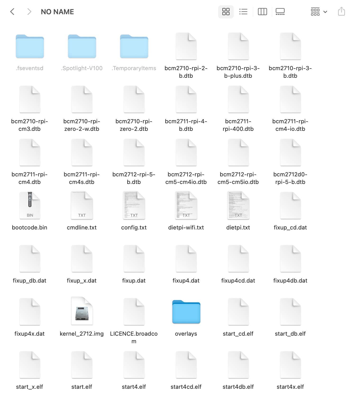

I’m using a Mac to see the files/folders, just from the file explorer - not sure if I’m supposed to do something else to see more…?
But here’s a screenshot of what I’m seeing, it’s mostly a bunch of .dtb and .elf files with a few .txt and one folder (overlays) with a ton of .dtbo files.

MacOS does only see the vfat boot partition, but you need the ext4 root partition.
You need to mount it on a linux machine.

Using a Linux VM on Mac should give access to the ext4 partition
