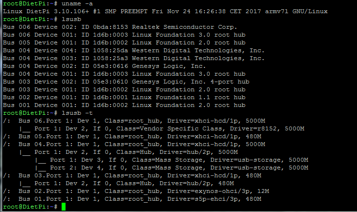

Here is the current output I see, which looks to me like the xu4 is recognizing my external hard drives as usb3 (5000M).  The read speed (78MB/s) seems to be above USB 2.0 limits (60MB/s).
