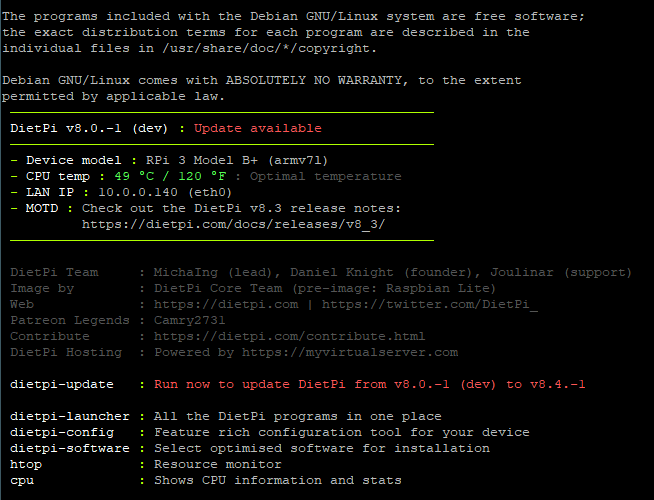

Anyway, here the login message:
Note:
the echo give me this answer :
echo $G_HW_ARCH $G_RASPBIAN
2 1

As well you are on development branch. Might be good to go back to master.

the capture that I’ve attached is before the update command,
if I run ‘dietpi-update’, no error, but at the end ‘autopurge’ hang the system,
