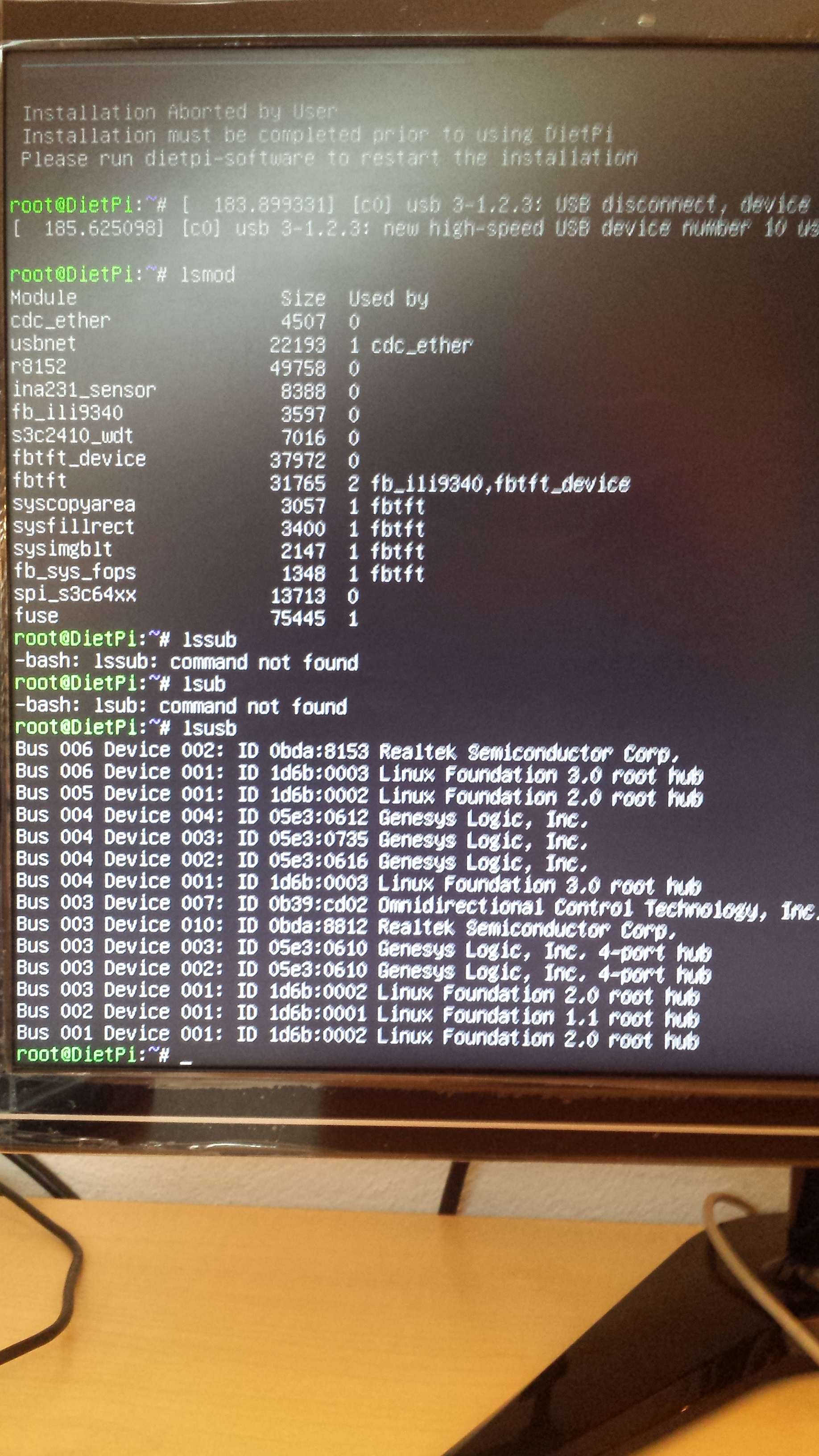

I attached the output of lssusb and lsmod as jpg format.
Plz help me since i dont know what i should do to get things work ;-(

Hi Soletto,
Looks like your device is:
0bda:8812 = 8812au
Have you tried probing the device?
modprobe 8812au
Its possible the kernel wasn’t built with support for your chipset, so it will need to be rebuilt.
