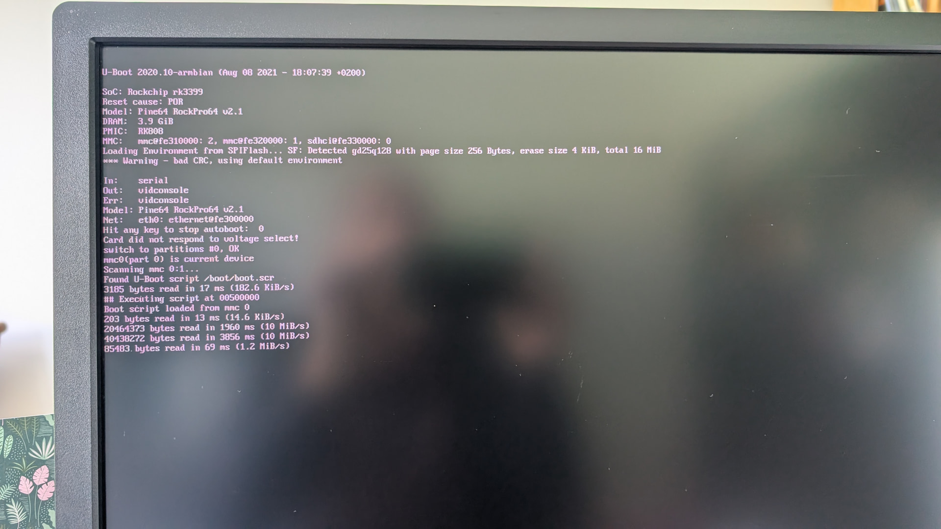

Can you verify that the system is booting when the HDD is connected, via UART or a connected monitor?
Is the USB HDD only powered via USB? If this is the case it is probably a power issue.
It’s also possible that it’s trying to boot via USB when the HDD is connected.
The system is booting but after a few seconds, screen freeze and I don’t see anything else. From what I see on the screen (see picture), the system boots using mmc
Most likely case so far.
