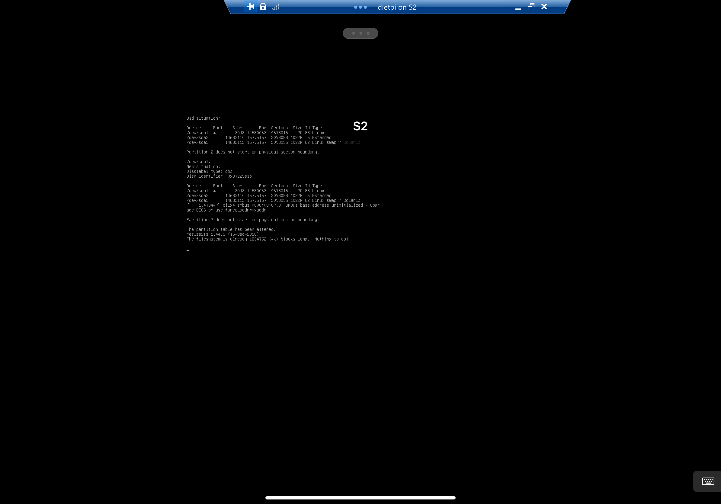

Hi, yes, it finished without any errors, but when I reboot, I don’t see any changes. This is the message at reboot.

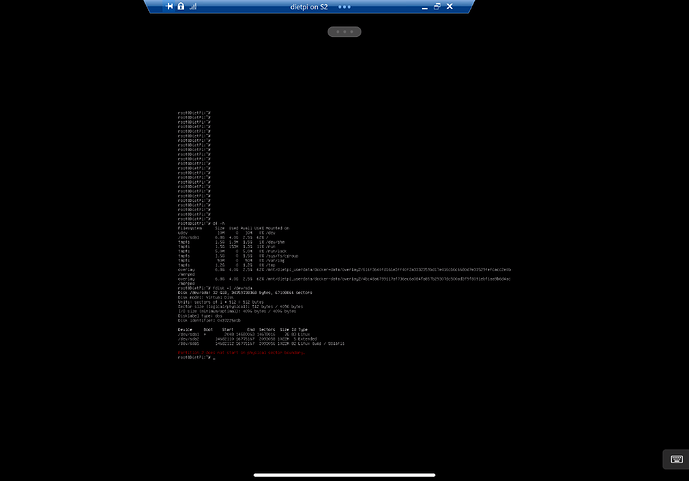

Hi, yes, also tried that from the menu system and also does not work. Not sure if the info below will help? The fdisk shows that the system sees the expanded hyper-v disk of 32G.
Something is wrong, look at the starting sectors for sda2 and sda5, they are just a few sectors away and end on the same sector, which shouldn’t be possible for different partitions?!
Maybe you can deactivate the swap, try to extend sda2 again and reestablish the swap.
You can try to drop sda2 and sda5 if they are not needed.

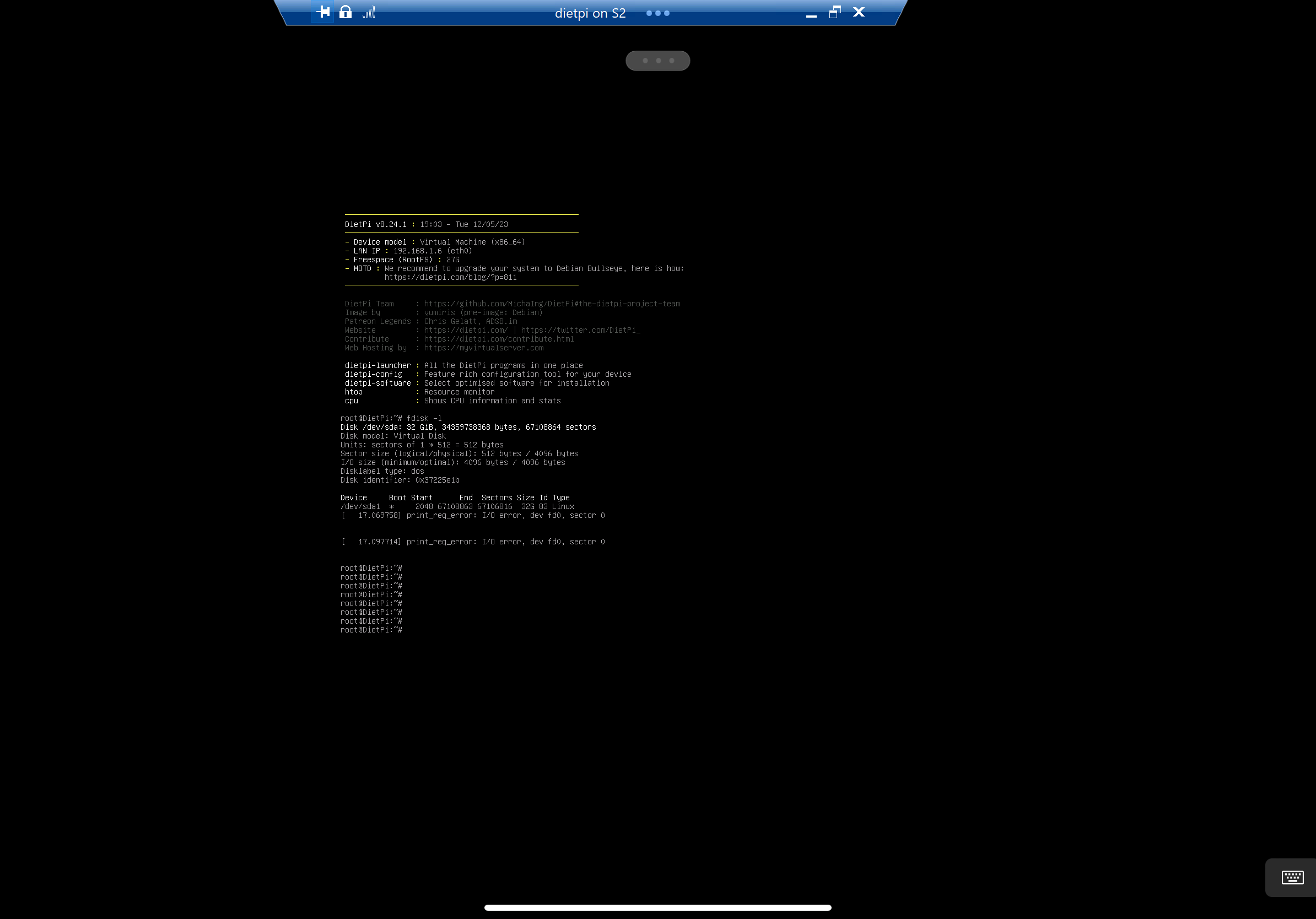

Hi, thanks for the tips. I delete sda2 and sda5 and re-ran the resize from the dietpi menu. After rebooting, the resize seems to work, but also seeing a message with I/o error? Is there a way to fix that?
fd0 usually refers to a floppy drive. I guess there isn’t anything like this attached? Maybe you can check your configuration
