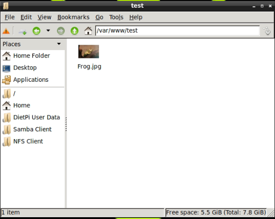

Can you create a test file in the webroot, e.g. /var/www/test and try to access it via /test, if that works /var/www/.well-known/test? If the files definitely exist but you get a 403, then some non-default Lighttpd setting is blocking it at some point, so let’s see where this is the case.
192.168.1.12/test = 403 forbidden
192.168.1.12/test/frog.jpg = 404 not found
And just to make sure we’re on the same page here.
But the file has a capital F, while you entered the URL with lower case f, isn’t it? ![]()
When you create an index.html in the test dir, accessing the dir should work as well. Although directory indexing sound be enabled by default add well.
But please try with the .well-known/acme-challenge dir, so that we test the extract access the ACME server does.
Did you install any other web application aside of Nextcloud?
Ok sorry yes its capital, I can access the frog through local ip but not remotely with the domain. I put it in the acme-challenge directory and I can see it on the network.
