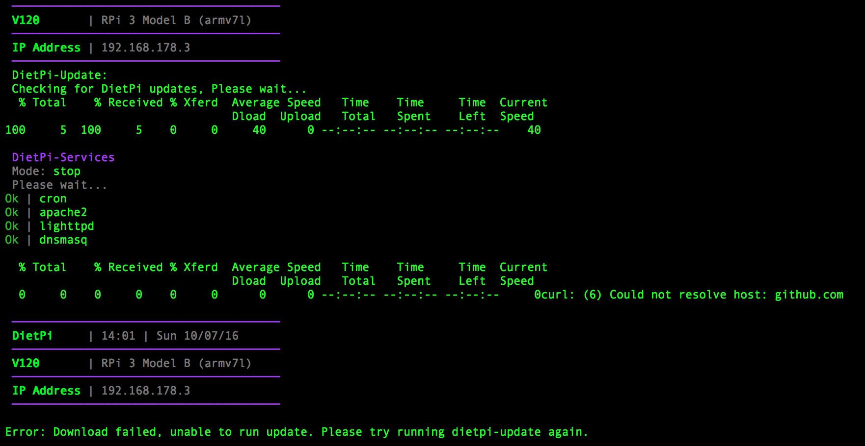

Hi friends,
I’m getting an error when I try to update to the latest version on the Raspberry Pi 3. I think it hast something to do with dnsmasq, because after the error pi-hole stops working and no DNS can be resolved. I have to reboot the device to fix it. Do you have any advice on how to perform the update?

Found the issue:
dns-nameservers 127.0.0.1
You can either change that line to:
dns-nameservers 8.8.8.8 8.8.4.4
Or use dietpi-config 8 1 as per the doc link I gave you above.

Thank you! That did the trick. I’m using DietPi. I meant that I’ve installed pi-hole by
curl -L https://install.pi-hole.net | bash
Thanks again, problem solved.
