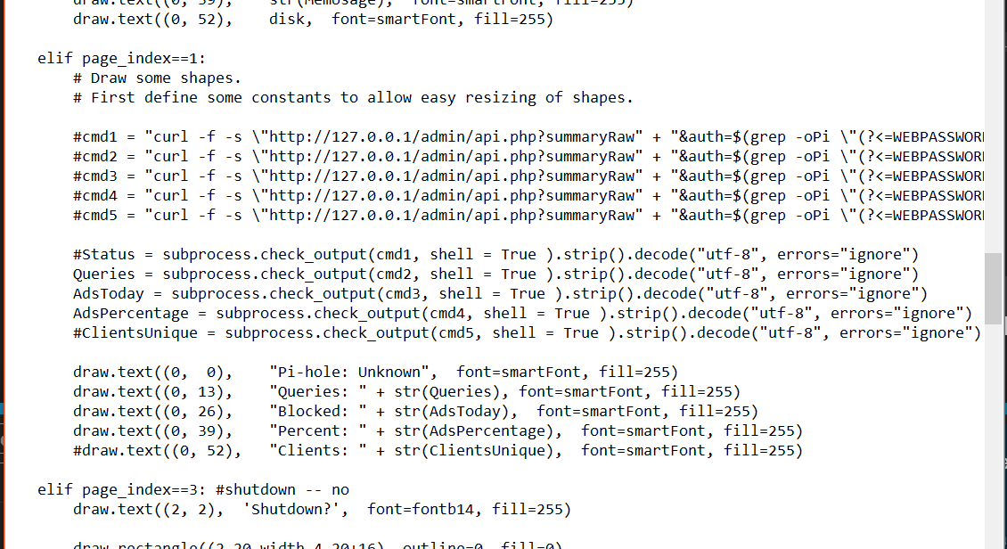

Yes sorry, I forgot to mention that I also tried everything with “https” as well but also with no luck. And sorry again, I think I’ve been sending us on a wild goose chase. So I tried implementing your solution above and was still not having any luck. UNTIL…
Mimicking the old python file I was trying to add all of your solutions underneath this “index==1” section here, but no mater what I tried the file would fail:

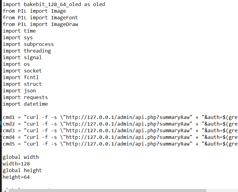

But I noticed in your small script above that works, the cmd line is right underneath the “import” section of the file. So… I moved all the cmd lines up to that part of the file here, and suddenly stuff started working:
Now this solution doesn’t fully solve the problem, it only works some of the time and still fails intermittently, but it certainly sheds some light on the problem; which I think has been a python syntax/order of operations thing this whole time. I’m going to keep plugging away at this thing until I can get it fully working again and maybe look for some help with the python if I get stuck. Thanks again for all the help.
