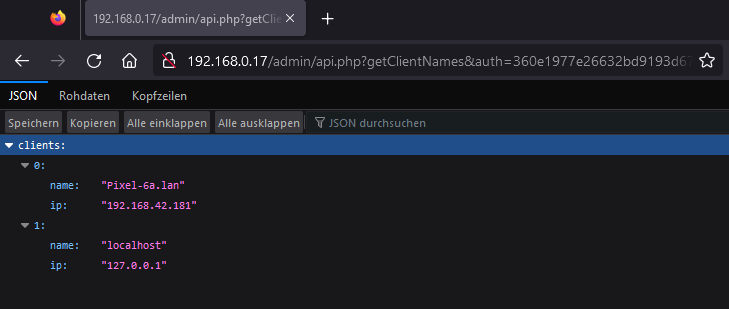

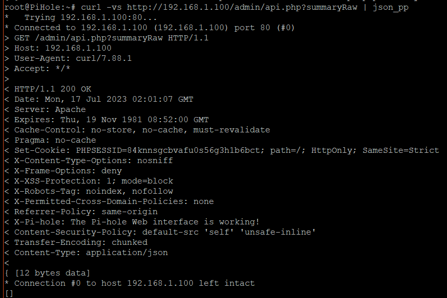

When you just call api.php you just get an empty array back. Also you need to authenticate yourself, try something like:
http://127.0.0.1/admin/api.php?status&auth=<TOKEN>
Where TOKEN is your API token.
Also with Pihole6 a REST API will be introduced :sunglasses:

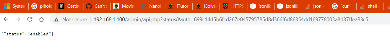

on web browser it’s working :smiley:

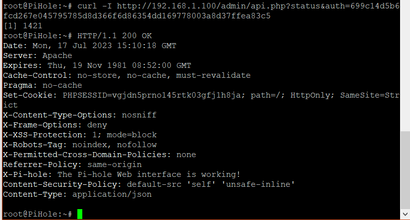

Trying a few different commands with/without the auth I still don’t think I’m getting the correct return:
In the web browser it does work for me too.
Maybe this helps? What is “X-Frame-Options: deny”

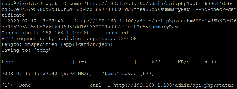

Ok after some testing and research I come to the conclusion that you can not grab JSON with curl. But you can get it with wget. I tried
wget -O temp 'http://<IP_ADDRESS>/admin/api.php?auth=<AUTH_KEY>&summaryRaw' --no-check-certificate
to save it to the file temp.
I needed the --no-check-certificate since it throws some errors (I think because of HTTPS redirect, but I call the local IP and not the domain, I think it’s bc of this, but not directly related to the topic)

Like this? On line 8 it’s still references JSON.
Yes, but it’s no saved to file temp (with the flag -O you can specify a output file) and from there you can process it further.

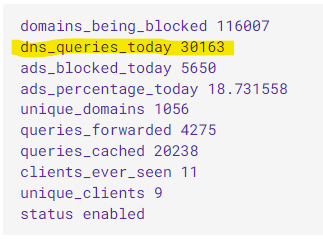

Ok, after testing all the commands it looks like the Telnet API (Telnet API - Pi-hole documentation) is the only one I can get to return any data. But now I’m stuck on trying to parse out a single value, say returning dns_queries_today only, from this command: echo “>stats>quit” | nc 127.0.0.1 4711

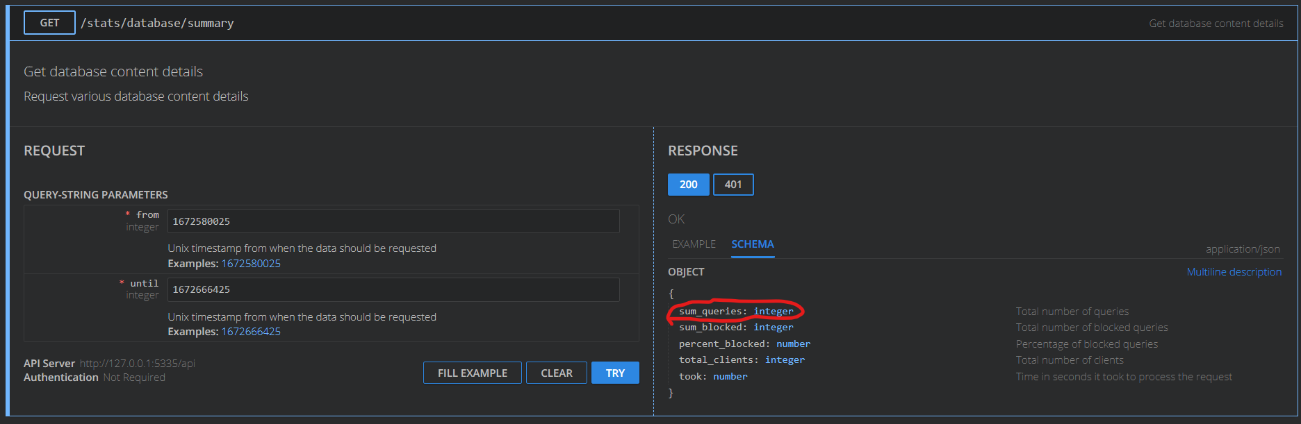

It looks like I’m going to have the same question for the new v6 REST API (Pi-hole API documentation) as well. How would I return just a single stat?
Is this something that can’t be done with a single line command? Would it have to be done using additional code in the python file? Because I’ve been trying to test that too.
Probably better to raise such questions within Pihole forum. There you have the experts that might be able to answer your question regarding the API usage.
This depends on how the devs implemented it.
You can filter your output e.g. with grep and cut
echo “>stats>quit” | nc 127.0.0.1 4711 | grep dns_queries_today |  cut -d\   -f2
This should return 30163 (number from your example)

Awesome, grep and cut returns exactly what I was looking for. No way I would have been able to piece that together, still trying to work it into my python script without it failing but it does give me the same return as my original cmd line. Thank you for all the help.
