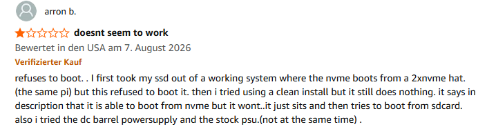

I have seen an Amazon review from someone who complained about the board not able to boot.
yeah I saw multiple people say that. it could be because of lots of bad power supplies or this company is bad at sourcing parts or even their fabrication of parts is bad or the shipper damages parts. last one would be stupid customers but i doubt that one.. I haven’t received my replacement pcie cable yet it will get to me about 2 to 4 days. I’ll know the part is bad when i test the board with this replacement part. at the moment i think its the pcie cable because it has a weird defect in it.
