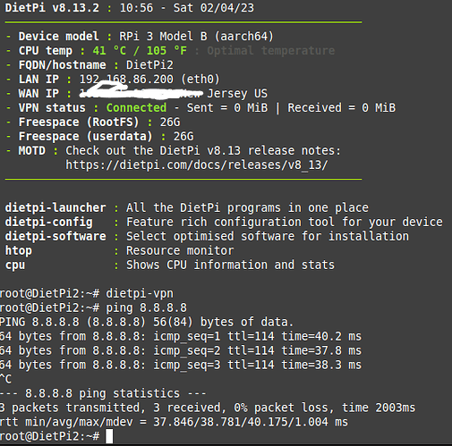

I went to my 2nd unit only running pihole and unbound and configured dietpi-vpn with the exact same settings and enabled the killswitch, and it still works without an issue. I feel like the VPN on my “main” isnt actually working even thought the WAN IP is listed as the VPN IP.
When the killswitch is enabled on the main I cannot even ping 8.8.8.8. When the killswitch is enabled on the secondary it pings fine.

Screenshot of the “Dietpi2” VPN config and being able to ping 8.8.8.8 with killswitch enabled
Output from “main” Dietpi after enabling killswitch and trying to ping 8.8.8.8
