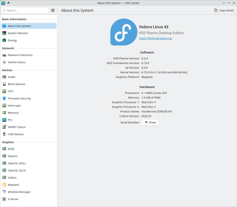

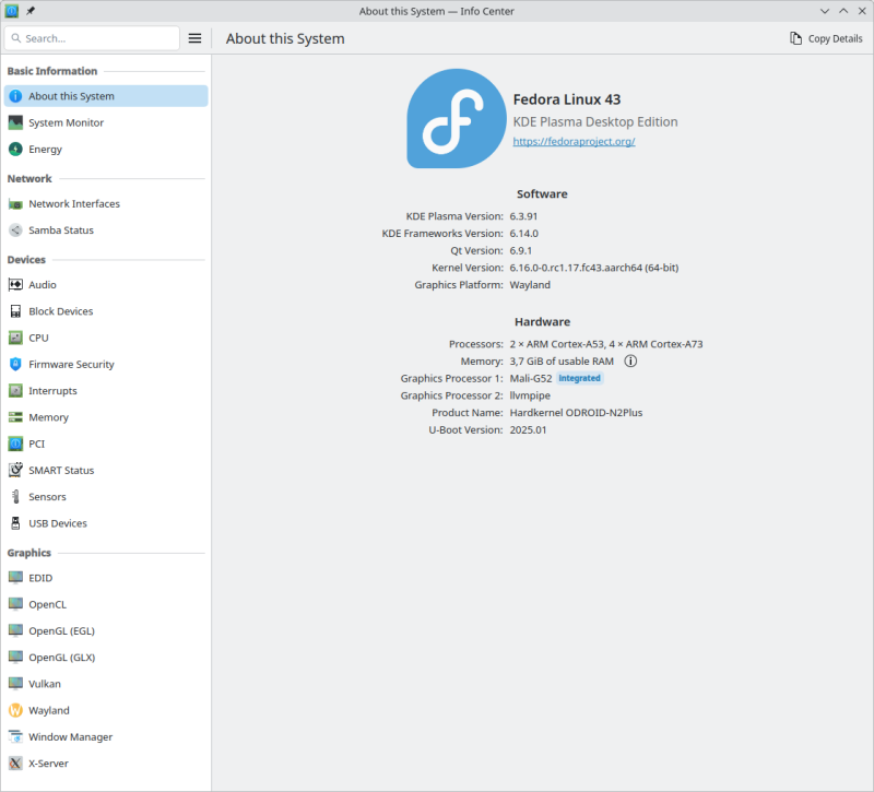

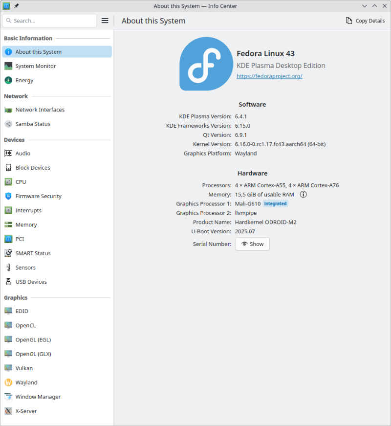

Since I was tired of being frustrated with the limited RAM capacity of my ODROID-N2+ (S29X SoC) — 4GB is simply too little for desktop applications like memory-hungry web browsers — I recently purchased an ODROID-M2 (rk3588s SOC). The device came as expected without suitable firmware that can handle common bootflows. Fortunately, the mainline firmware support is already available out-of-the-box, so only a corresponding build was required. I was surprised to see a kernel starting while trying to test my first firmware build, but I had overlooked that I was using a microSD card with which I had previously tested a jumpstart image that I had created for someone else to bypass a USB initialization issue on an ODROID-N2+. So I shut down my ODROID-N2+, it is currently running my latest operating system from an USB enclosure with an included NVME SSD. Disconnected the USB enclosure from the ODROID-N2+, plugged it into the ODROID-M2, and turned it on. About 30 seconds later, I was confronted with this:
And no, I haven’t forgotten to mention it, I have made no modifications to the OS or the bootflow. It was planned to replace the ODROID-N2+ with the ODROID-M2 in the long term, but so far I haven’t switched back here even once:
The M2 works significantly better than the N2+, although no device-specific modifications were applied. And with the performance, it far surpasses my ODROID-M1 (rk3568), which has been functioning equivalently for a long time:
I had expected a significantly more extensive bring-up based on the current statements circulating on the internet, but with current software, it was child’s play. The fact that some video decoder support is still missing (hantro support is already available) is only secondary; for desktop applications, even software decoding is acceptable since even 4K content is usable. Only the fan, which runs due to CPU load, can be potentially annoying. But the mainline support is just around the corner.
