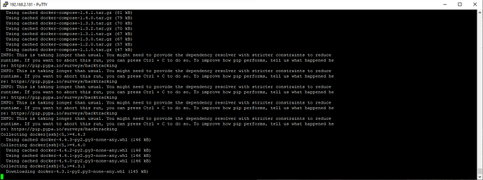

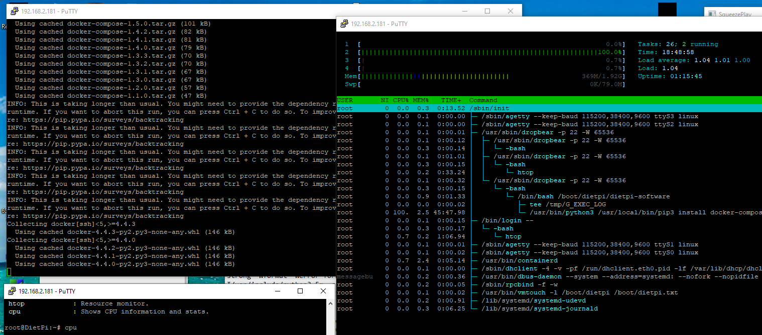

Unfortunately it doesn’t finish. Hangs halfway through the install. The attached shows the CPU at 100% although the RAM is only at about 30% (2GB RAM).
Tried to re-run without success. Stops at the same spot. Is there a way for me to delete the local cache and download the packages again or is there anything else I could try?
this could take time while compiling. Let it run for 1 hour pls.
It ran for more than 2 hrs before I killed it. Looking at the resource monitor I still see CPU% and time incrementing. Does this mean the process still runs? How long can I expect this to run?
Also what about the cache? The log says Using cached ....
. Could this be corrupt or do the packages automatically refresh every time I restart the process?
