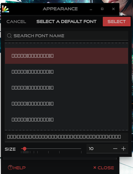

  1. using XFCE or LXDE I have no fonts (only black squares)

Did some duckduckgoing…found this
square fonts means missing fonts
Did you install xfce-goodies as well?
Check out nomachine…it’s a pretty decent remote-desktop application…but VNC should work just fine
i changed to LXQD and could solve my appereance problems… Not only theissue with the mouse is open. What must I do that my Dietpi machine (Intel based) recognizes an USB dongle to use wireless keyboard and mouse. Thanks Karl
