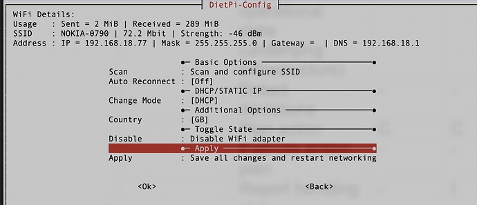

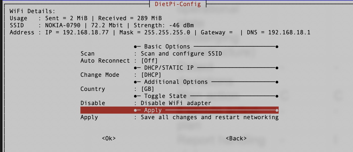

Hmm., Thought I replied to this already, I guess not. I pinged the Ip address directly. I tried both x.x.x.76 (the ethernet address) and x.x.x.77 (the wifi address). With the RJ45 connected both work. With it disconnected neither work. Here, for laughs, is the configuration:
Whoa! This may be working via wifi. Shut down (power off). Removed RJ-45. Restarted. Waited a fairly long time. Connecting via x.x.x.77 (wifi) now works. Although GUI shows x.x.x.76
