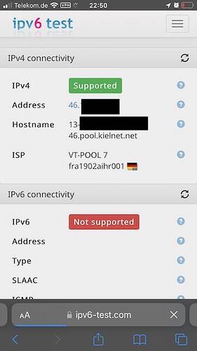

With VPN Wireguard IPv6 doesn’t work
Without Wireguard IPv6 works
Can someone please tell me what I am doing wrong? I would like to be able to access servers on the internet with IPv6 via the VPN.

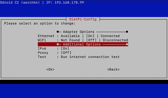

In the dietpi-config IPv6 is activated.

My router assigns an ipv6 via dhcp.
root@bkiste:~# /boot/dietpi/func/dietpi-set_hardware enableipv6 enable
 DietPi-Set_hardware
 Mode: enableipv6 (enable)
[  OK  ] DietPi-Set_hardware | Desired setting in /etc/hosts was already set: ::1 localhost ip6-localhost ip6-loopback
[  OK  ] DietPi-Set_hardware | Desired setting in /etc/hosts was already set: ff02::1 ip6-allnodes
[  OK  ] DietPi-Set_hardware | Desired setting in /etc/hosts was already set: ff02::2 ip6-allrouters
[  OK  ] DietPi-Set_hardware | Desired setting in /boot/dietpi.txt was already set: CONFIG_ENABLE_IPV6=1
[  OK  ] enableipv6 enable | Completed
