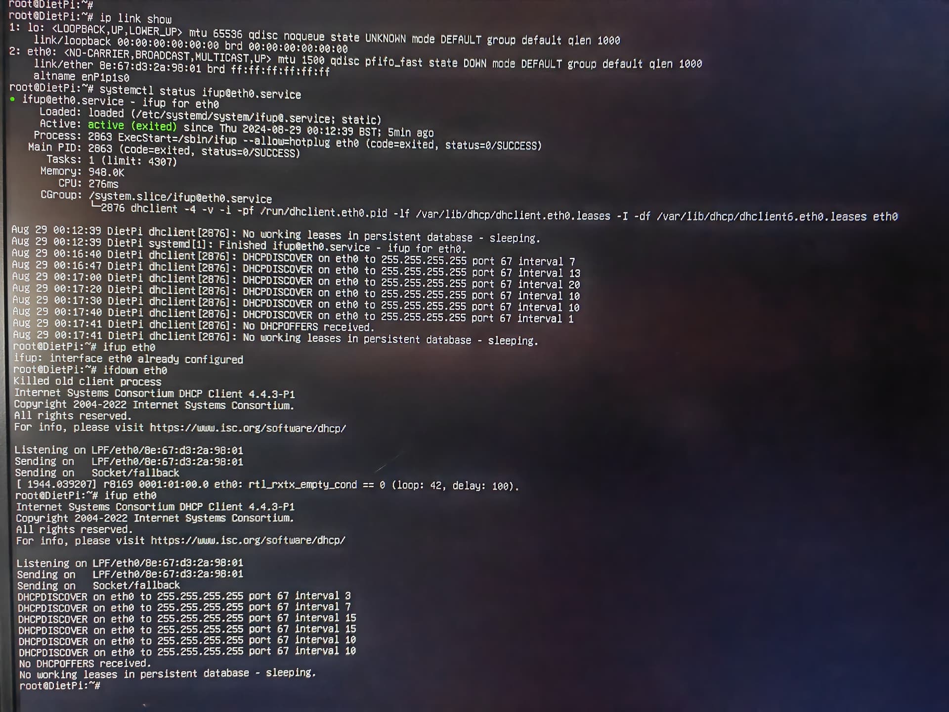

After updating to kernel version 6.6, I can no longer connect to the Internet.
The yellow LED only flashes on one of the two LAN ports. The other LAN port is not recognized.
I have also reinstalled the system twice and it still does not work. Maybe the information in the picture will help you:
Does anyone have a suggestion to fix the problem?
Thanks in advance :grin:!

Thanks for your suggestion. The Ethernet connection now works with both DHCP and Static IP, but only for about 5 minutes after system start. After that, all hosts become unreachable. I’ve also noticed that the MAC address changes with every restart, which causes the system to get a new IP address if i use DHCP.
