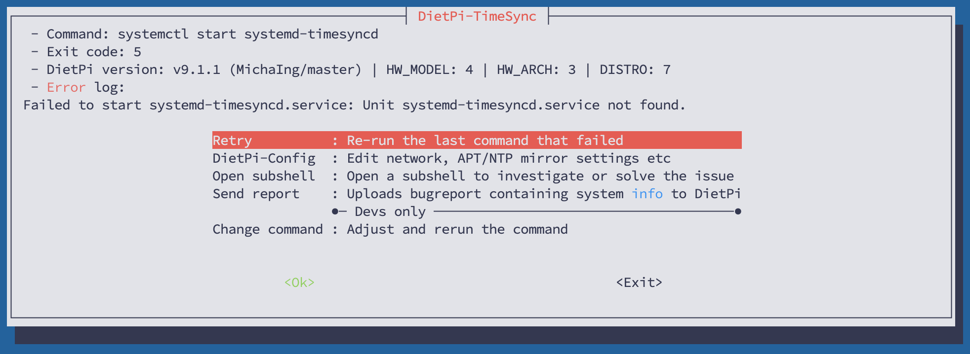

Dietpi-update problem with timesync
Details:
  • Date | Tue Feb 20 10:36:53 CET 2024
  • DietPi version | v9.1.1 (MichaIng/master)
  • Image creator |
  • Pre-image |
  • Hardware | RPi 4 Model B (aarch64) (ID=4)
  • Kernel version | Linux bookworm 6.1.21-v8+ #1642 SMP PREEMPT Mon Apr 3 17:24:16 BST 2023 aarch64 GNU/Linux
  • Distro | bookworm (ID=7,RASPBIAN=0)
  • Command | systemctl start systemd-timesyncd
  • Exit code | 5
  • Software title | DietPi-TimeSync
Steps to reproduce:
  1. call “dietpi-update”
Expected behaviour:
  • update should run without any issues
Actual behaviour:
Extra details:
Additional logs:
Failed to start systemd-timesyncd.service: Unit systemd-timesyncd.service not found.
IDK why this happened and why he service is missing on your system, but to circumvent the issue you can select Change command and just type true and hit return, it should continue then without the time sync check. But if your system time is out of sync this could lead to new problems, so I recommend to make a backup before you try that.
