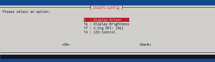

It’s the last entry in the submenu of 1 : Display Resolution .
Thanks I will change that.
I don’t have that option:
Headless mode has only a meaning on RPi, where GPU memory allocation, framebuffer and HDMI signal stack can be completely turned off to save RAM and energy. On x86 systems there is no generic way of doing that which has any benefit, at least not to my knowledge.

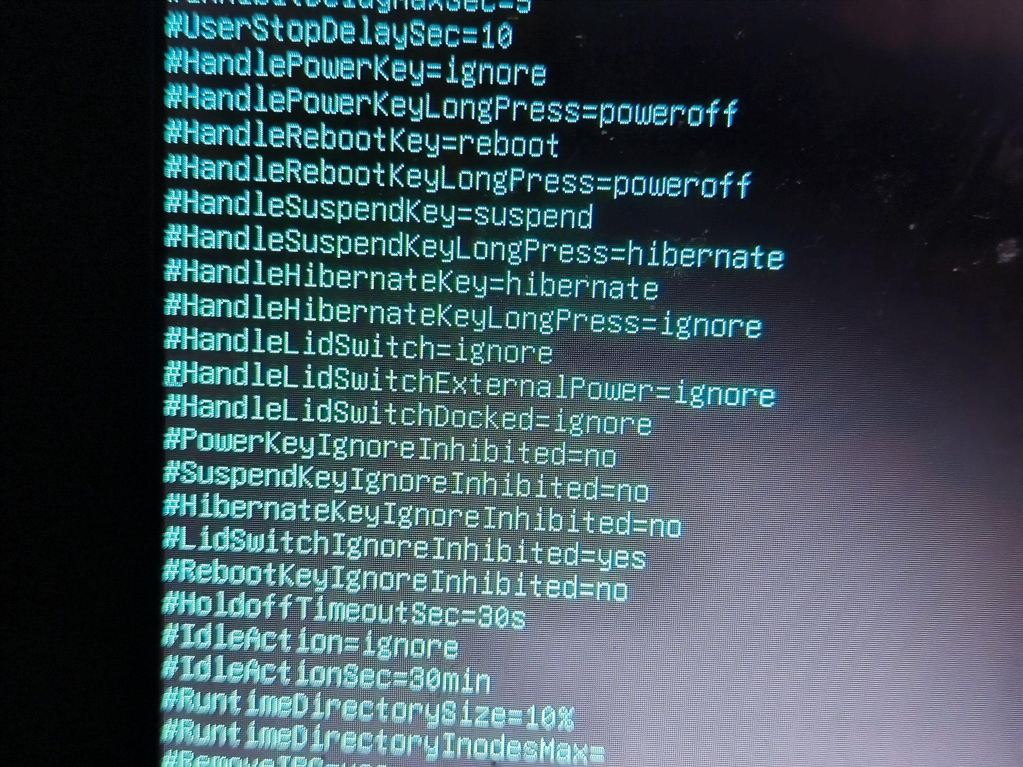

I Like to use my old N3050 Notebook as Raspotify-Client. An maybe later as a wifi-hotspot.
I’ve changed all the systemd configuration lines with “lid” inside to “ignore”, safed it and did a reboot but the notebook does still suspend when lid is closed
The logind.conf is safed correctly, I checked it three times and try to restart the service aswell
I’ve also Change “handlepowerkey=ignore” but it didnt work aswell, the powerkey still shuts down the Laptop.
I also tried xfce4-power-tools using the gui in lxde but that didnt work aswell.
Any ideas?
@ForenSeil hi, you need to remove hashtag to use the parameters.
