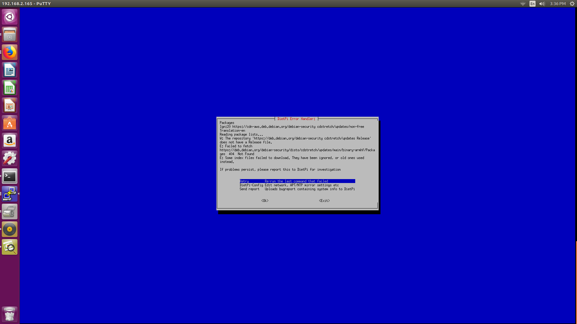

I am using odroid xu4. I have installed dietpi 0s v6.9. I am not able to install softwares sucg as build-essentials and git from dietpi-software.
It displays error as follows:
After that I thought to install it using command line.Even at that point it is not yet installed as displayed error
So, I need to know whether v6.9 supports these installation.
Thanks
saiakash
Your APT repository looks a bid strange: cdstretch?
Could you try to reset it to default: /DietPi/dietpi/func/dietpi-set_softwarte apt-mirror default
and retry APT installations?
