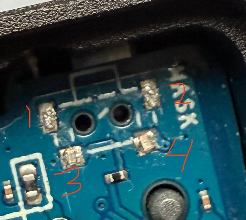

My SBC is a NanoPi R5C. As per the documentation, I have to press the MASK key during bootup to access a sort of recovery mode to wipe the eMMC. Unfortunately, I have pressed too hard on the button which caused it to dislocate :frowning: I am still able to login through SSH. Is there a way to reformat/clean install it from within? Thanks!

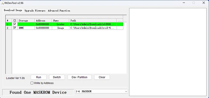

here is what I did to reformat the eMMC with the busted MASK button.
  1. Download RKDevtool v2.96 and DriverAssistant from this link
  2. Download loader (MiniLoaderAll.bin) based on CPU model from this link
  3. Install both downloaded files from step 1.
  4. Start RKDevtool application.
  5. Plug the USB cable to the port near the mask button.
  6. Short the pins 3&4 using paper clip before plugging-in the power cable.
  7. RKDevtool should detect your device.
  8. Point the Loader parameter to the location of MiniLoaderAll.bin and the downloaded dietpi image to the Image parameter.
  9. Click Run. Dietpi should now be flashed to the eMMC module.
