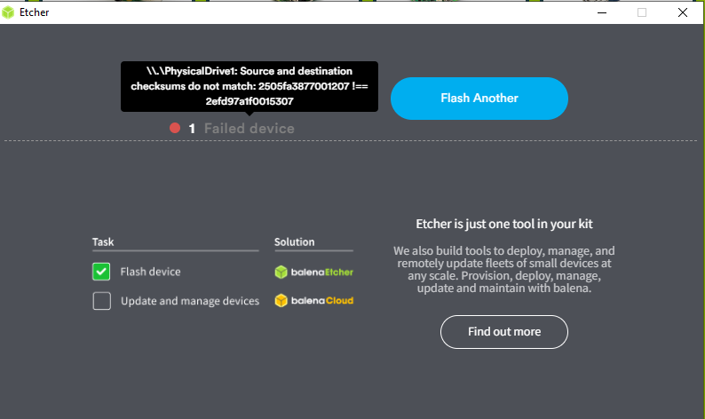

Upon doing the flashing of the image again, I noticed that the “source and destination checksums do not match”.
Perhaps this is the problem (or part of)?
Also, the image archive cannot be downloaded from the dietpi website anymore - it comes up with an error as well.
So I used the “failed” re-flashed image and this time dietpi installed with a ping error.
I ran the last action again and reconnected to wifi, and it did its updates and installing.
Everything seems to be installed now.
