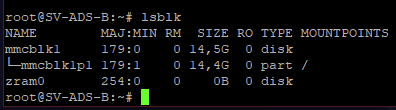

I assume that in the following screenshot, mmcblkl(pl) is the SD card and partition, and zram0 (presumably) is the eMMC (and if so, why show they 0Byte size?)?
Does it make sense, if that’s even possible, to clone the SD card onto the eMMC and then boot and run the system from the eMMC without the SD card? I also suspect that it must be handled differently by each manufacturer?
Especially considering the durability of SD cards, that would certainly make sense, right?

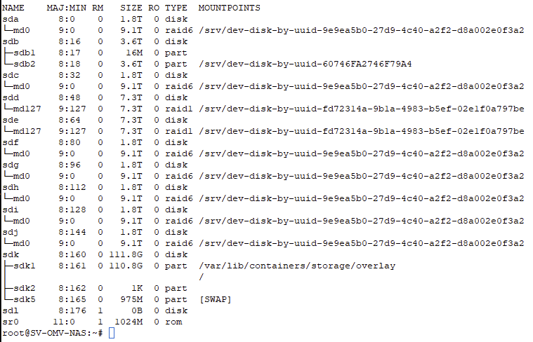

Are you sure? I once learned that the lines visually connect the partitions on a disk to the physical drive. It’s the same with my NAS:
Yes, you’re right. I’m currently using the 3W with eMMC for the 1st test runs. I just realized after your comment that the 3E doesn’t have an eMMC…
