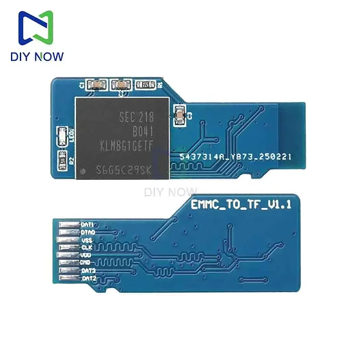

I just found this on AliExpress:
EMMC to TF Card Module BGA153 BGA169 to for Micro SD Card MMC Card USB 3.0 Card Reader HS400 Is Required PCB Module
