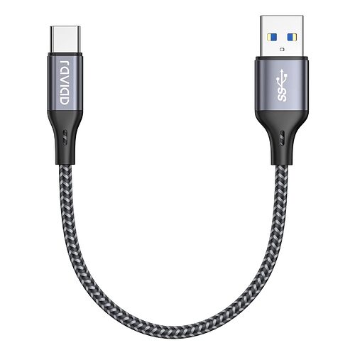

I am using this USB-C UBS-A cable (2m length, sorry this page is from Italian Amazon):
because Sabrent USB-C USB-A cable is too short for my needs.
Maybe to test I can move Sabrent unit closer Odroid N2+ to use Sabrent cable (it’s a complicated move but I’ll try).
