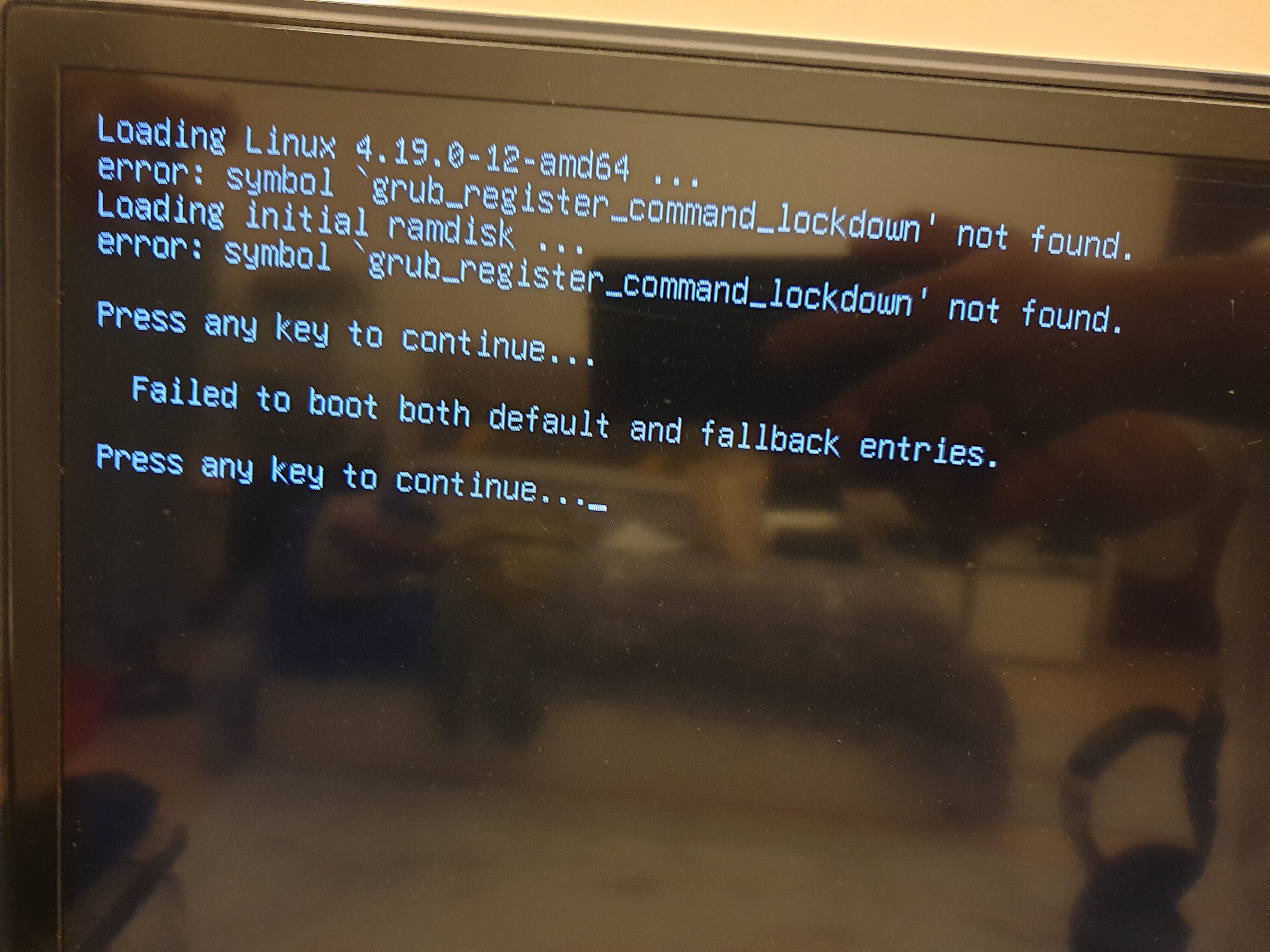

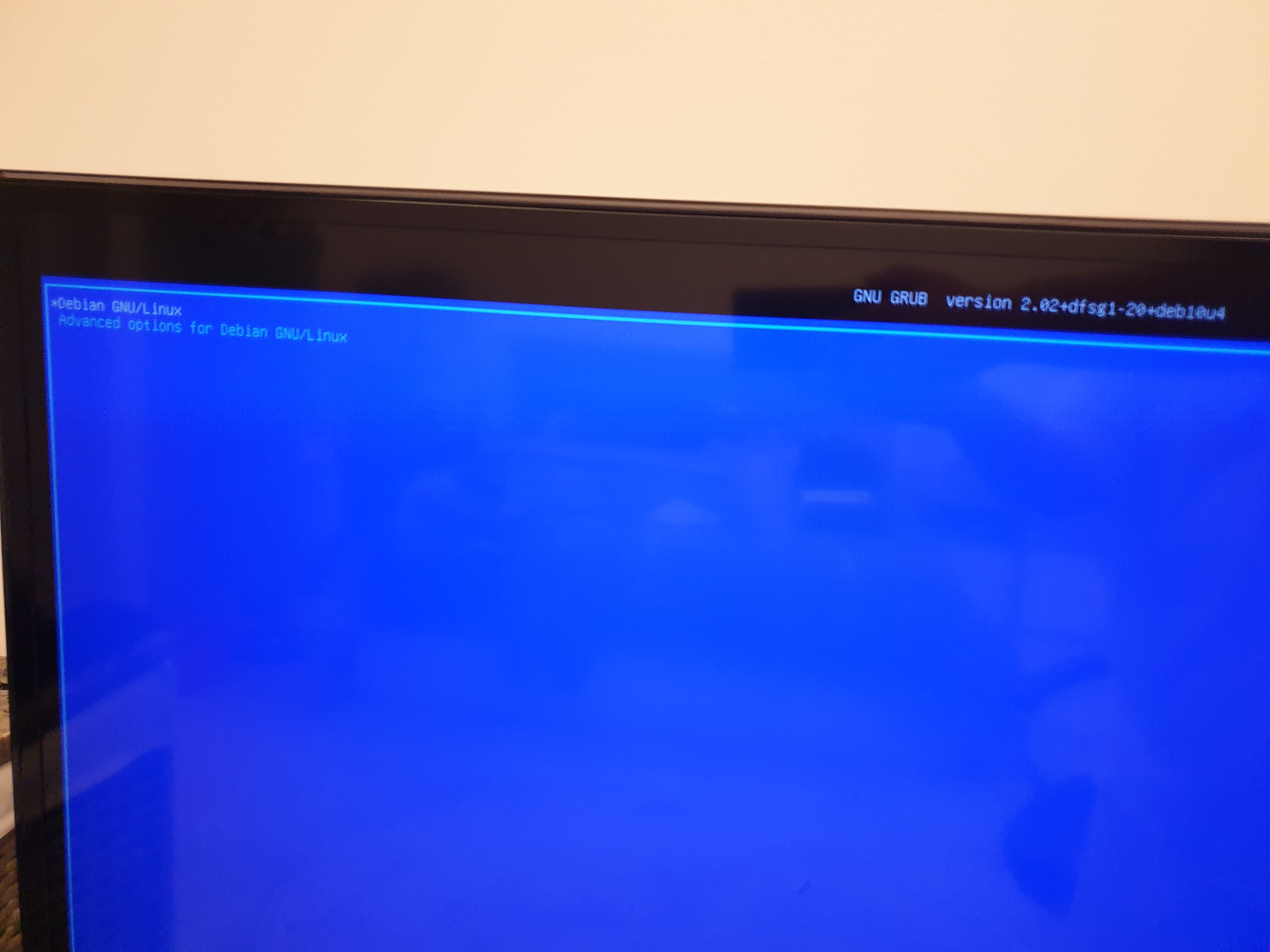

I updated Dietpi on PC Lenovo Thinkcenter but after that it won’t start . Please see the attached pictures . I don’t want to lose the files
whatever option I chose it leads to the same error . Please help

There seems to be an issue with the grub boot loader. Not sure if we can do anything on this.

I was able to fix the problem ! I just followed these steps :-
https://help.ubuntu.com/community/Grub2/Installing#via_ChRoot

. The underlying issue seems to be that on upgrade grub was flashed to the wrong drive. Similar to this. It seems that the underlying issue has never really been solved: The ability of the grub install script to reliably detect the correct drive it was booted from.

Is it an EFI image or BIOS?
Do you have the ability at early boot to select the OS for some seconds? In this situation, hitting c should bring you into the grub command prompt. If so, it is possible to manually boot from there and then re-install grub: https://archived.forum.manjaro.org/t/solved-grub-problem-grub-rescue-but-the-installation-done-on-external-drive/80188
Else, and probably easier, is to boot form an attached USB drive, or attach the affected broken drive to another system and repair grub from there.

It’s BIOS . I was not able to boot the system at all . I tried through grub command prompt but also nothing change . The boot from internal hard disk
