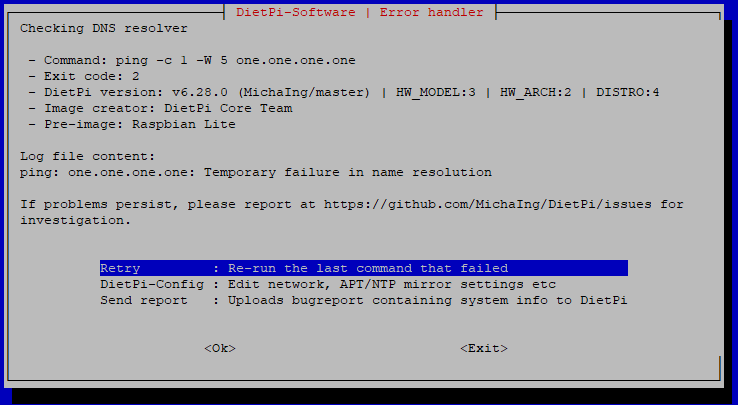

I wanted to update pi-hole with “pihole -up”. Unfortunately it got stuck during the update and I had to restart manually. Now I get the following error message:
I tried “dietpi-update,” but here’s what I get:

[FAILED] DietPi-Update | Unable to access any update server. Please check your network connection, then rerun dietpi-update.
