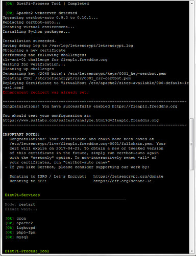

Thanks Fourdee! I run your code:
/DietPi/dietpi/dietpi-letsencrypt 1
and this is the result (it seems no renewal has been performed yet…why?)
now my certificates expires in 23 April 2017
Looks fine, so in theory the cron.monthly job would succeed when its triggered.

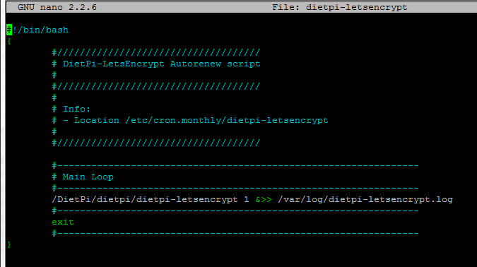

And lets confirm the cron job exists:
ls -lha /etc/cron.monthly/dietpi-letsencrypt
Fine thanks, I did as you suggest and into the /etc/cron.monthly/dietpi-letsencrypt that what I see (should be correct)
thanks again!
