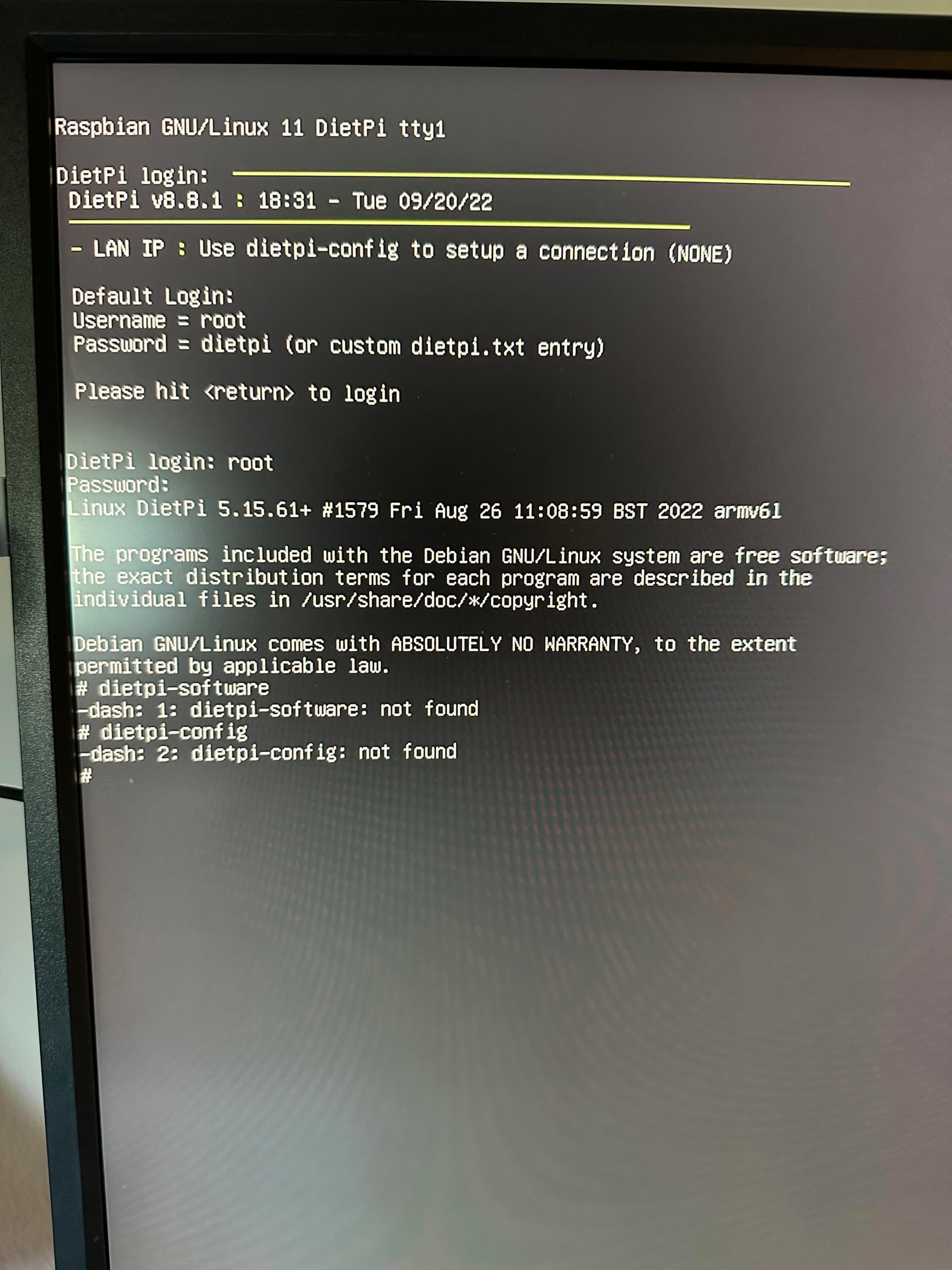

On a fresh installation on a Zero W, everything works with the user dietpi, but not with root user (no dietpi- functions and no tab for autocomplete).

New to dietpi here, I read the install instructions on dietpi site, flashed 2 sd cards with the ARMv6 32-bit image in order to install it on a Pi Zero W 1.1 and a Pi Zero V1.3 with a waveshare ETH-USB-HUB-BOX hat for the 1.3 Pi. Installation runs smooth, I get the dietpi login screen and ssh is working on both units. But for some reason I dont get any of the Dietpi-commands to work.

Could be this issue DiePi own distribution script - no bash · Issue #5771 · MichaIng/DietPi · GitHub
User should try this
usermod -d /root -s /bin/bash root
Login again and check
It’s from reddit.
I hope the guy is willing to debug :slight_smile:
Nothing to debug. We simply need to create new images. In meantime people can use the workaround to get things working.
workaround: usermod -d /root -s /bin/bash root
